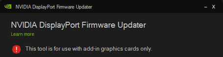

Anyway I’ve checked the mentioned nvidia DP FW update but its not working for notebooks (makes sense as the ports are designed by the Notebook vendor in the end)
