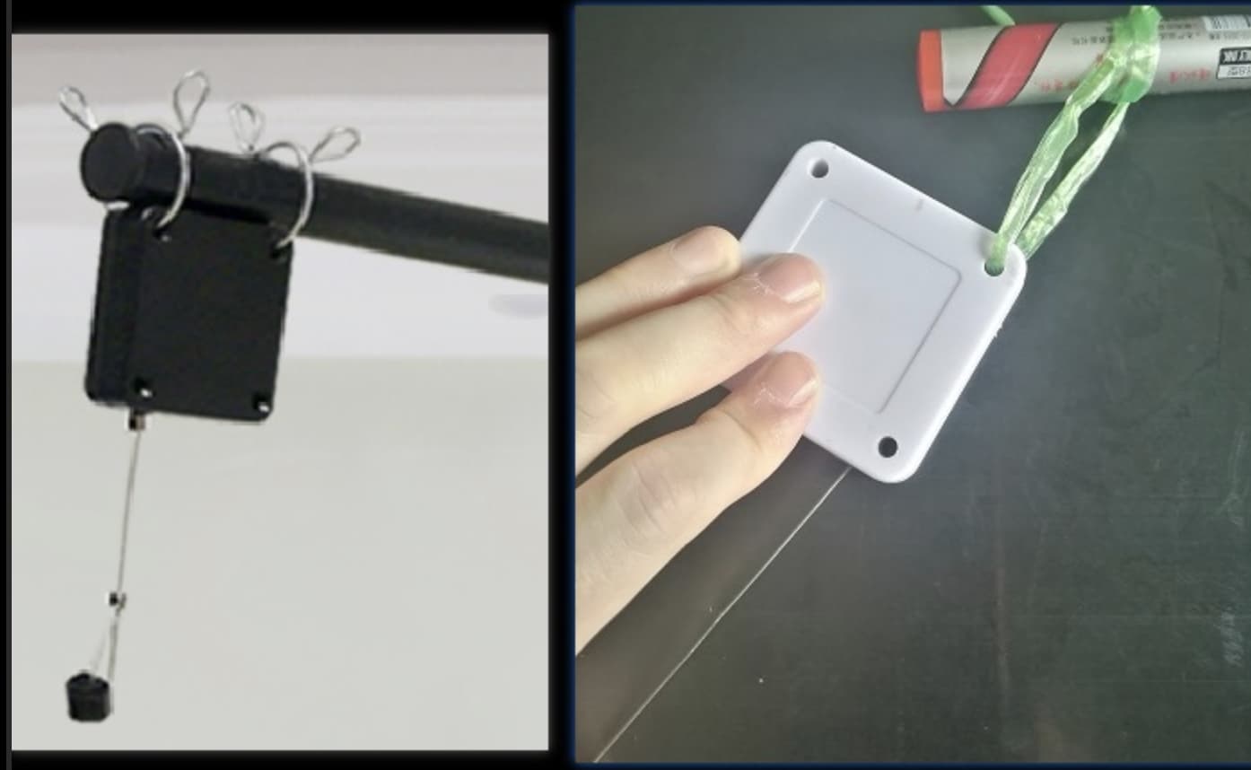

1 Rotate the VR cable organiser 360 degrees.
A. The basic technique of bundling the VR cable organiser is as illustrated on the left below; however, this method is incorrect! The correct binding procedure is indicated on the right, which involves passing a rope through a small hole in the cable take-up box and then bundling it on the organiser.
B.The traction force of the VR cable organiser is equal to the rewinding force of the coil spring plus the friction force generated by the wire rope and the copper ring of the rope outlet, and the rewinding force of the coil spring is generally unchanged except when the spring fineness is near the maximum value. However, when the angle changes, the friction force created by the wire rope and copper ring changes as well. The friction force is greatest when the angle between the wire rope and the copper ring grows narrower, or even when the angle is almost parallel, and it is so great that the copper ring develops deep scratches, which enhances friction (If the organiser is broken, you may replace the brass tip.
C.Keep the wire rope as vertical as possible with the copper ring mouth, use a single rope to bind the wire cable organiser and the bracket, which allows it to rotate 360 degrees, the wire rope is less likely to rub against the copper ring, but there is one thing to remember, in order to ensure the best angle, the rope must only pass through one hole in the small hole of the wire (which close to the copper hole)
