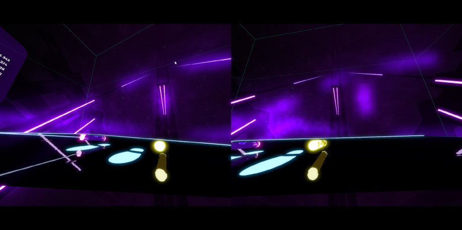

The bloom and reflections are mismatched, do not play without parallel projections.
here’s a pretty clear example, you can see on the right eye the bloom is in the same screen space position as the left eye and therefore not aligned with light sources or geometry. this can cause discomfort or even headaches as your brain fails to combine the two incompatible perspectives.

I’m getting this issue with PP on as well, am I the only one or am I missing some other step that needs to be done to fix the lighting mismatch?
If you have it with PP on, then chances are that you do not have the PP on.
I switch PP as usual in Pitool and then make sure to restart SteamVR. I’ve been doing so for years on my 5k+ when switching between games.
Then the problem is most likely that for some reason your headset remains stuck in native mode, even when you turn on PP in PiTool. There is no way you can get this type of error in Pimax headset if PP worked correctly.

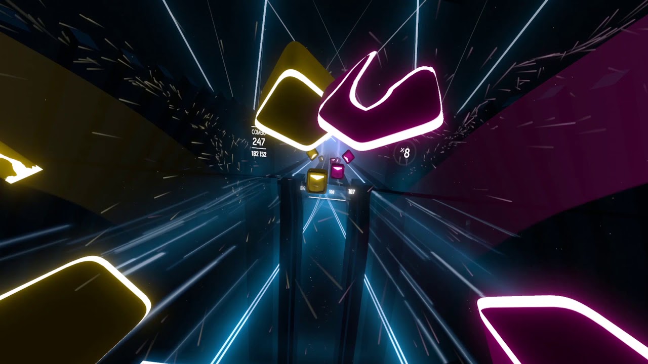

whats wrong with Beat Saber on Pimax? its running fine
Here is my game video. (Pimax 8k)
Ok thanks, I would have given up if you hadn’t seemed so sure. After switching from 90 Hz to 72 Hz (probably not the actual issue, just what fixed it for me) it seems PP activated and the problem is gone.
I was not able to correctly enable PP, even after a computer restart it actually wasn’t active on the HMD even though it was checked in Pitool. Turns out switching refresh rate (and then back) fixed the issue for me.
Did you click the Apply or Save or something? In past it was enough to check the box but now think you need to also Apply it. Or it was just stuck in some bug state as risa200 suggested…
Hey, you solved it! What a stupid UI… Save only saves the checkbox selection, it never applies the setting even if you restart the service or the computer. Man, they really should merge that save and apply button into one that does both.
