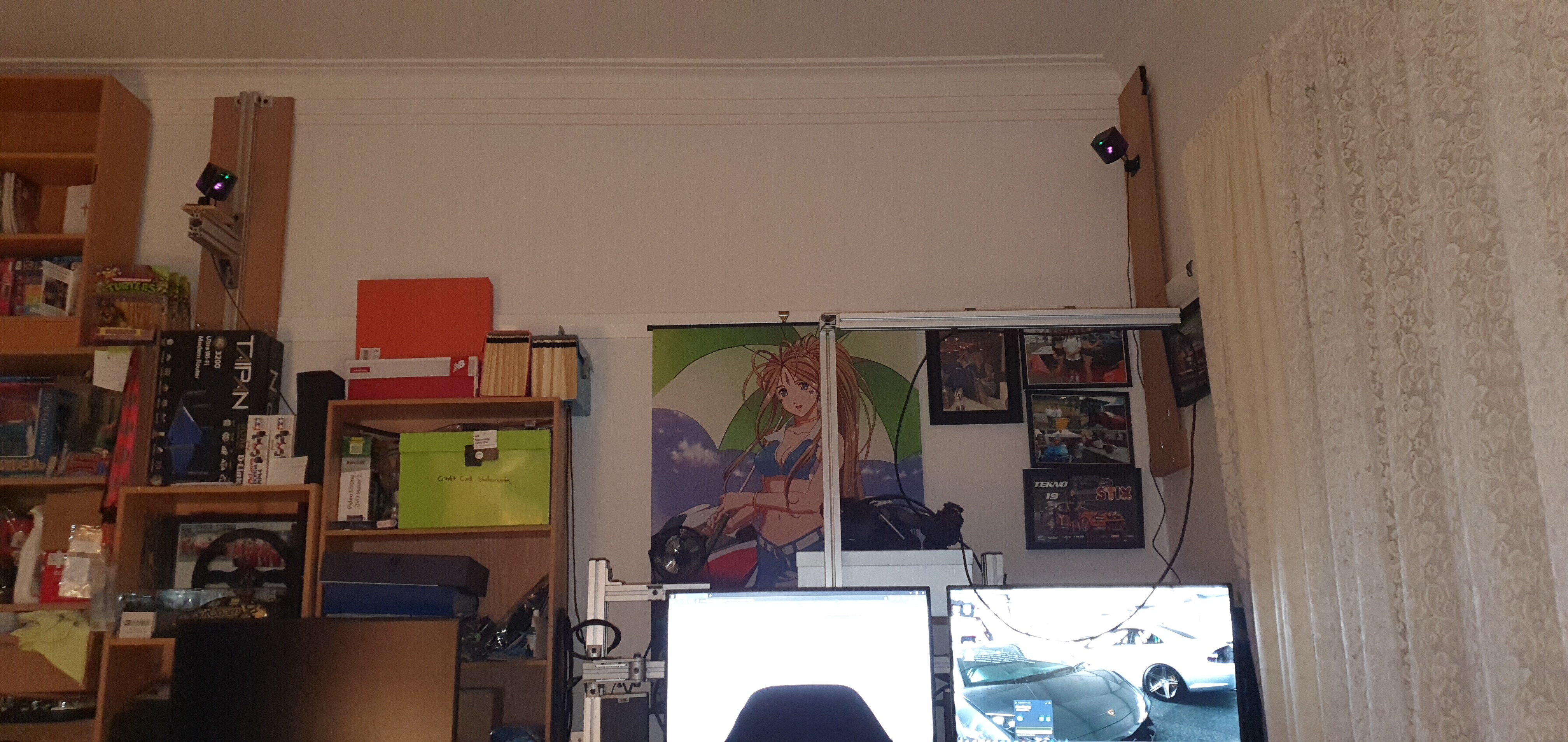

For the last month I’ve been conducting a little experiment with 1.0 and 2.0 Base Stations. The reason why? I’ve been having the drifting / jitter or movements while my head is being still say in the Steam VR home or it’s more prevalent in a race car in Iracing especially with a SFX-100 DIY motion sim turned on. I know EMI can cause this but I’ve tried Chokes, rings and filters.
I wanted to find out and test whether a 1.0 base station would be more still and indeed there was much less drifting or movement. Only issue was when the headset was touched on the left or right sides, the tracking would be lost, more so with the motion sim on. In my instance, the 1.0 is more sensitive. To regain the tracking, the headset had to be taken off and rotated 180 degrees. This is not ideal especially while trying to adjust something. The 2.0 Base Station is much more forgiving.
So I tried another 2.0 Base Station. This time a Vive brand. The first 2.0 is a Valve boxed version complete with longer power cable and wall mount. The Vive branded Base Station is identical to the Valve version apart from a shorter power cable and no wall mount. I tested this and it had similar drifting/jitters or movements compared to the Valve version. So I’ve decided to sell the HTC 1.0 Base Station. I haven’t decided on a price yet.

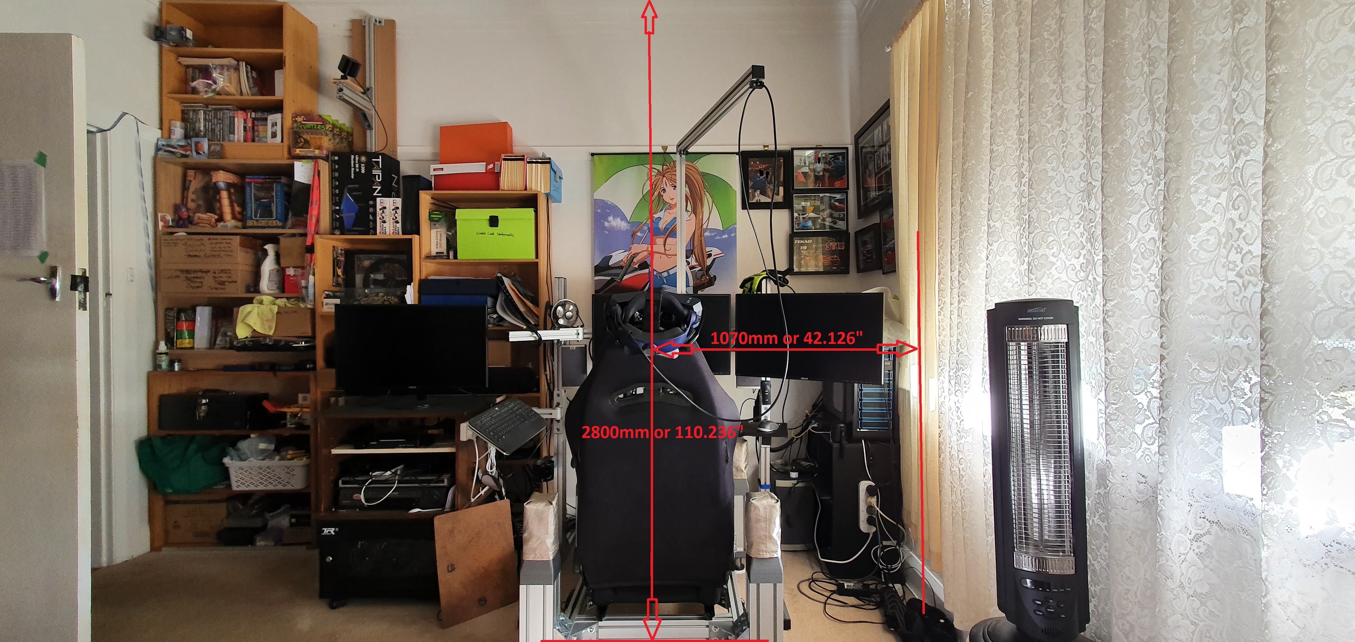

I’d like to ask about where’s the possibility of mounting a 2nd Base Station in my room on the right wall so the tracking works?
I don’t have the option of moving my rig around as I have set the layout of my room and this works. Currently my rig sits 1070mm to the left of the right wall. The ceiling is 2800mm tall. I have a picture rail which I use for the current Base Station and I made a wall bracket as I don’t want to drill into the Brick Cement walls. This is 2100mm high. My seat is between 1100-1200mm back from the facing wall.
