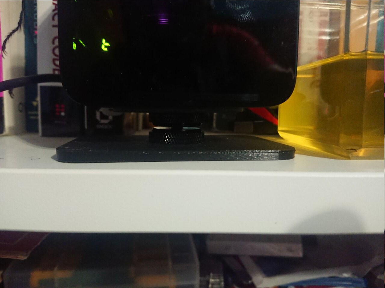

Update: I built a small pedestal using this https://www.amazon.it/dp/B00OT75QTA?psc=1 and a 3d printed plate (the end result in the photo below), but the issue is still there without external help for cooling, pointing a fan to the base station is working, after some minutes the base station get back to solid green light. So I will go on with the fan until it die, and search for another one.
The idea of the fixed mount is making the base immovable. I am not sure how the printed plate helps with that. Is it glued to the shelf? Anyway, since it seems it is heat related, it might not matter.
Just out of curiosity, what is displayed on the segment display? It looks like “t”.
It’s a b, the only mode I think should work (master without slaves).
