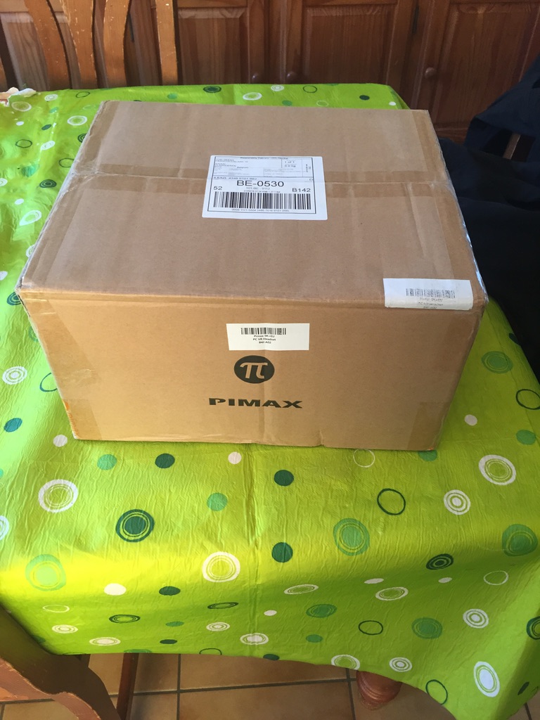

Arrival
I am backer #7106 from Belgium, I received my headset on monday 25/02 (DD/MM for all those American weirdos out there). At the moment of opening the box it was immediately clear that I have a first gen hmd. You can guess that from seeing all the posts about cracks I was afraid I will have to RMA it very soon.
