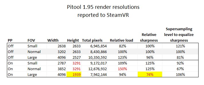

Pitool (and most games) use quadratic scale, which means you set how much to upsample in both directions of the view. This results in exponential load on the GPU as 1.5 supersampling really means 1.5 x 1.5 = 2.25 more pixels to render. Most in-game supersampling also works this way (eg. HMD Image Quality in Elite Dangerous). SteamVR uses a linear scale so 150% really means 150% more load. You can check this in SteamVR (or fpsVR) by looking at the final resolution. So here is the formula for net resolution:P^2 * G^2 * S = R
P: Pitool quality slider
G: In-game supersampling
S: SteamVR supersampling %
R: Net supersampling % to be rendered by gameSince what really matters is R, I simply keep both in-game and Pitool settings at default, I set the supersampling in SteamVR on a per app level.
Using above formula, I found I can maintain a reasonably stable 90fps in most simulators (except DCS) with a net 55% supersampling on a normal FOV with parallel projections. Unfortunately using this 55% gives you a much softer and pixelated image, somewhat resembling the original Vive in clarity which is quite disappointing. Basically, for demanding games, you need to make a choice: sharpness or smoothness. You can’t have both on today’s hardware.
For built-to-VR roomscale games, I can disable parallel reprojections and use a net 100% (or more) supersampling for a sharp image. Onward looks great for example (although it has some other issues, like peripheral culling or gray haze).
One important thing to mention: resolution is not consistent across different FOVs as of Pitool 1.95, and enabling Parallel projections support further complicates matters. See my post about this here (https://community.openmr.ai/t/psa-pitool-render-resolutions-are-not-linear/12079). The increased resolution of Normal FOV (PP on) might just be a bug, though.
