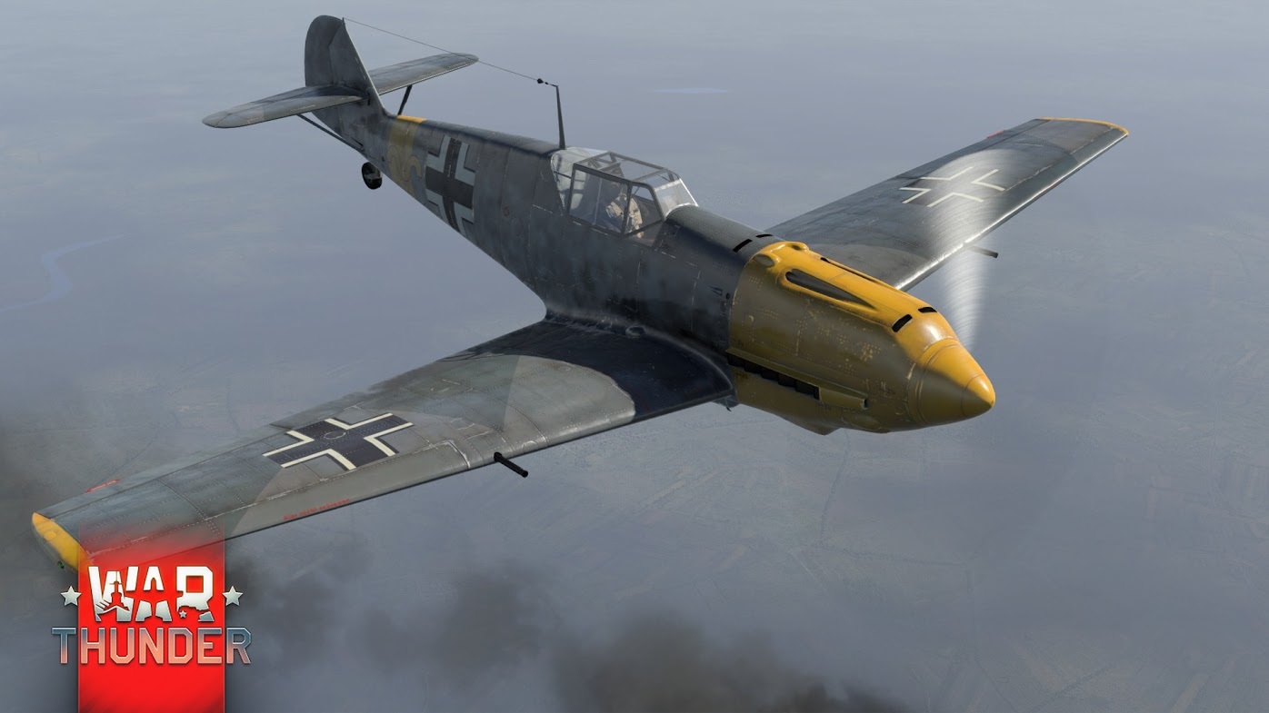

The bf109 e series has rectangular wings :slight_smile:
Ah see, my lack of aeronautical knowledge again. So does that mean the 5k+ image is more accurate?
I guses so …
I guess I could recognizant the 109 in the 5k+ picture …
No way in the 8k one … :frowning:
Like I said, it looks more like this.
https://www.redsradiocontrol.com/ekmps/shops/simonredmond/images/6s-pre-order-receive-in-approx-14-days-flightline-rc-spitfire-mk.ix-1600mm-63-wingspan-pnp-1402-p[ekm]1000x666[ekm].jpg

Yeah, this is one of the variations of the BF-109 with boxy wings, but they improved the design to introduce elliptical wing tips and the shape of the 8K picture simply looks more like it, getting narrower towards the end and having a straight line of the forward part of the wings rather than appearing to have the tips tilted forward. Sorry…
Anyhow, generally the picture comparison reminds me very much of playing around with the sharpen tools in Photoshop & Co… When you sharpen a picture you get the nice effect but the uniformity of plain areas will start to suffer, showing annoying patterns. But from a distance it still may look better, but it is a delicate balance.
