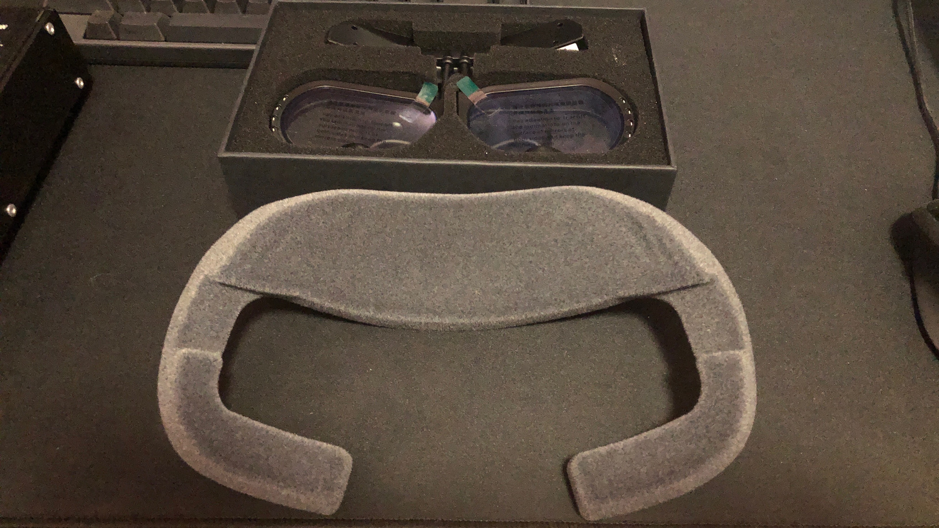

- Face foam
Seems Pimax has decided that they will only include the thin foam? Mine had the one attached to the HMD and no other foam.
People that wear glasses might have a problem with this. I do wear glasses, but basically there is no clearance between your eyeglasses and the lens of the HMD. Depending on the design of the eyeglasses you wear and the length of your eyelashes, this may be a problem. My eyelashes barely touch my eyeglass lens when I have the HMD on, but if any closer, this could be distracting/annoying and might smear the vision while gameplay.
In comparison to my 5K+, the lens has definitely come closer to the eyes.
Edit: As it turns out, thanks to the many people who informed me, it was a mistake to have only one foam and there should be a thick and thin foam included. I have sent a ticket the same day I originally posted, and I have received the thicker foam together with the eye-tracking module today (Sept 30th).
So if you have only had one face foam in your box, I encourage you to create a ticket especially since there is a chance that the thick foam may make the HMD fit better to your face.
For me, the thicker foam not only makes the HMD fit better, now my eye distance from the lens has comfortable clearance while wearing glasses, and on top of that, the IPD matching seems to work better as well.
If I elaborate, I had no problem with my eyes focusing on the displayed image on the 5K+, but with the 8K X, after testing it for more than a few hours, I started to notice that my eyes had a harder time maintaining focus. As in, my eyes will lose focus every now and then when I lose concentration, which was not the case with the 5K+.
With the thick foam attached to the 8K X, I don’t need to concentrate to focus my eyes as well. So I believe it would be a good idea to ask for the face foam since you will never know until you try.
