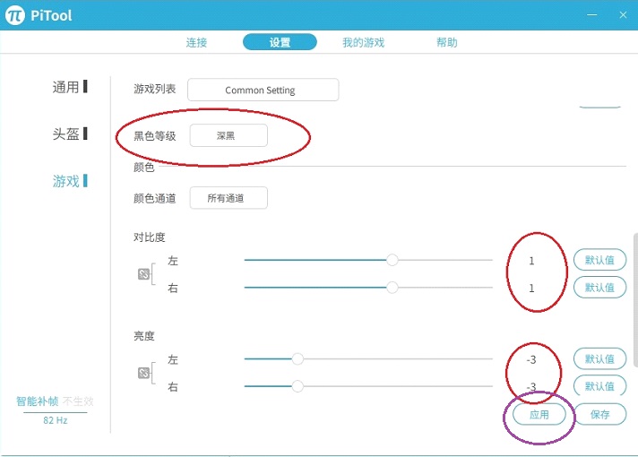

First, reduce the whiteness of dark scenes and adjust the contrast and brightness
1, only choose 1 for contrast, -3-2-1 for brightness, or -1 for brightness if it’s too black. Select the right application and restart the helmet

一,减少黑暗场景时的泛白情况,调节对比度、亮度
1,对比度只选1,亮度-3 -2 -1都行,太黑就亮度-1,选好点应用,重启头盔
2,oled的小派5k xr有黑色等级选项,可进一步减少泛白情况,lcd的小派没有
