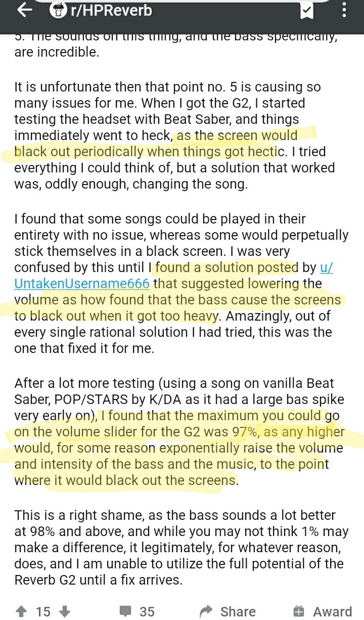

So strangest thing happened on the G2 last night. So I’m playing Pistol Whip via reverb.
And every time a shoot a pistol when customizing the gun the right eye woukd go black sometimes and if i shoot again the left eye would go black.
only way to fix was pushing the steam vr button to go back to the menu then it woukd go back to normal.
Ok weird I thought must be revive.
Then I start playing and everything is good until I pistol whip an enemy. The screens would do it again.
Its almost as if the headset blacks out the eyes when there is too much bass.
But I shrug it off as a revive issue and decide to play boneworks
but it happened there at some point too! WTF?
Then I stumble across this.
have you seen anything like this?
@NextGenVR maybe you?
Edit: Seems like this may be x570 related. As it seems reading that reddit that alot of users experiencing this are on AMD platforms. :grimacing:

I usually listen at 50 to 70% volume in the G2, so I’ve never experienced this personally.
I was just about to say that 97% volume seems fairly high… :nerd_face:
Have never heard the Index/G2 speakers though, but it’s almost never a good idea to max out the volume on any device for various reasons (there are exceptions of course)… :flushed:

What can I say i like loud volume.
I feel like its a weird thing not to be able use your hardware to its fullest. (Pun Intended)
Not really ok.
Plus what a weird bug…:crazy_face:
Hearing loss is a real problem.

The index speakers being off ear, I simply don’t find them loud enough. My play space is next to the boiler room which is quite noisy.
I’m actually finding the index speakers to be at quite the disadvantage if you dont have a perfectly silent playspace.
Anyway its not much of an argument. What if I told you this.
Hey I bought this new car, but when I put my radio volume too high the brakes stop working.
That’s ok, i never turn my volume up to above 95% anyway.
:rofl:
This is not the correct attitude.
you can easily fix a piece of padding to the speaker to make it more headphone like
even without, I tried 70% and it was almost painful, went back to 60%, I can’t imagine how bad someone’s hearing is that they need 90+%
I mean, come on, you know what the fix will be, they’ll make 95% the new “100%” and it will fix the problem, but someone will still complain the headset isn’t loud enough
and saying this is worse than any problem Pimax had, oh boy, I don’t even know where to start with that one, I mean at least I can actually hear the G2 speakers and they aren’t on top of my head
But this goes up to 110%
