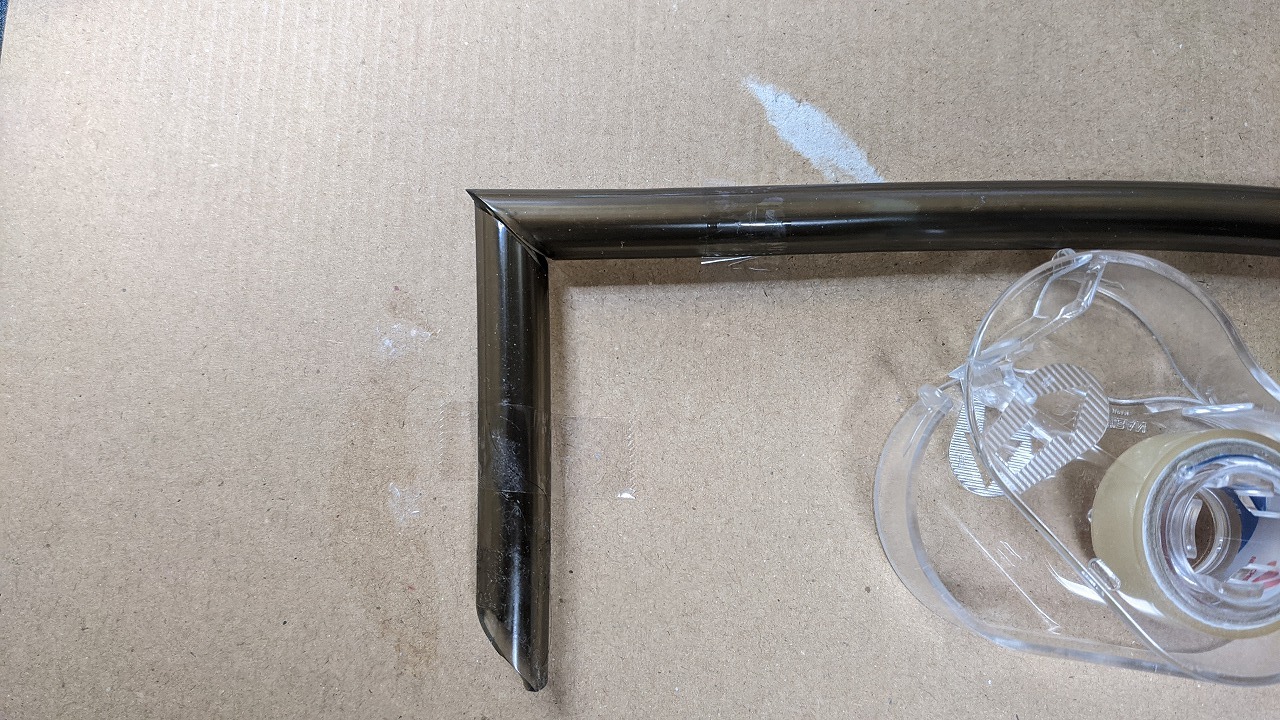

Use a tube with an inner diameter of 8 mm for tropical fish air circulation.
Cut at 45 degrees.
Cemedine CA-213 Adhesive for Vinyl, P20 ml
https://www.amazon.co.jp/-/en/dp/B0036WHO12/?coliid=I3UVVSRG04OQOR&colid=8NDOUCYISQNH&ref_=lv_ov_lig_dp_it&th=1
Glue it at a 90-degree angle with vinyl adhesive.
Use the adhesive for vinyl.
Secure with tape until the glue dries.
