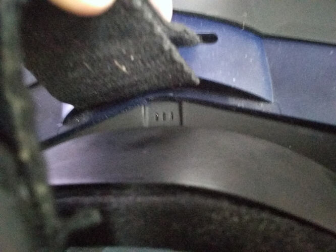

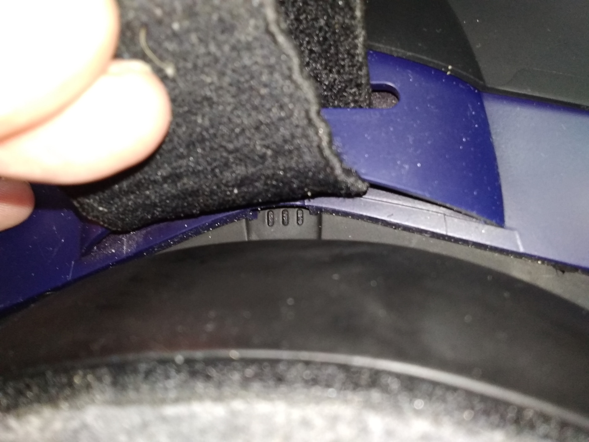

Original face mask in headset top

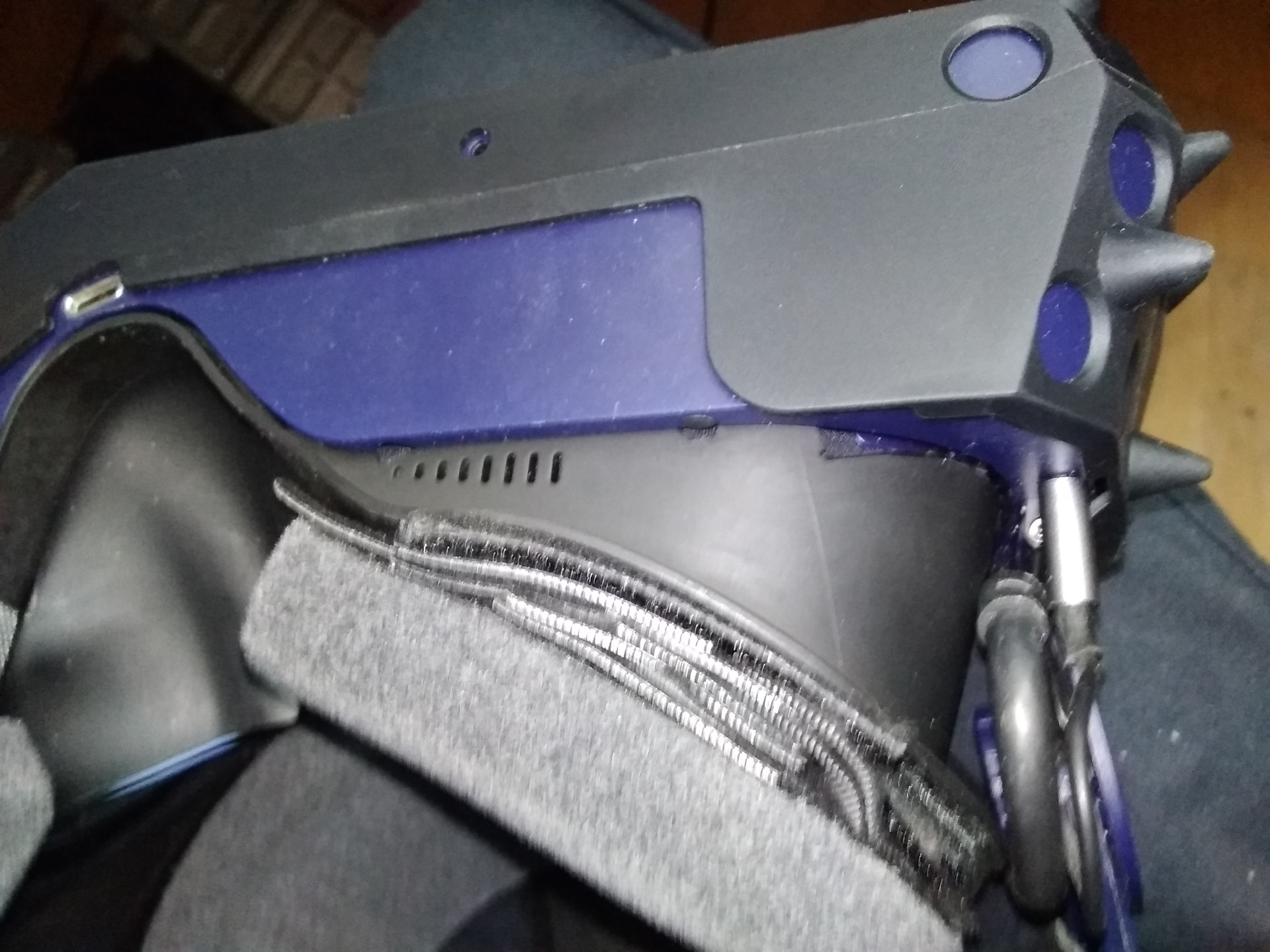

Modified face mask in headset top
Modified face mask cushion gap fill

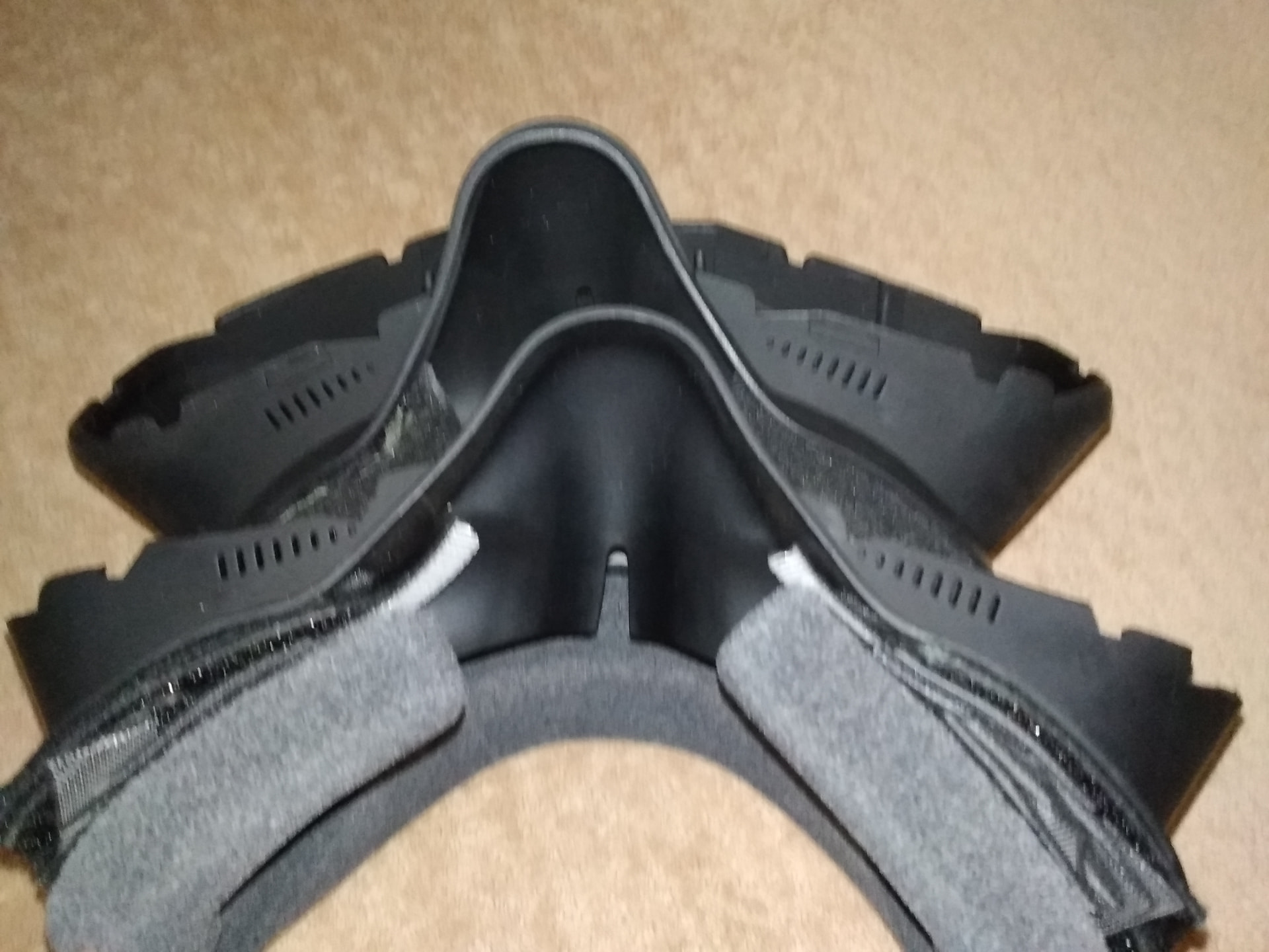

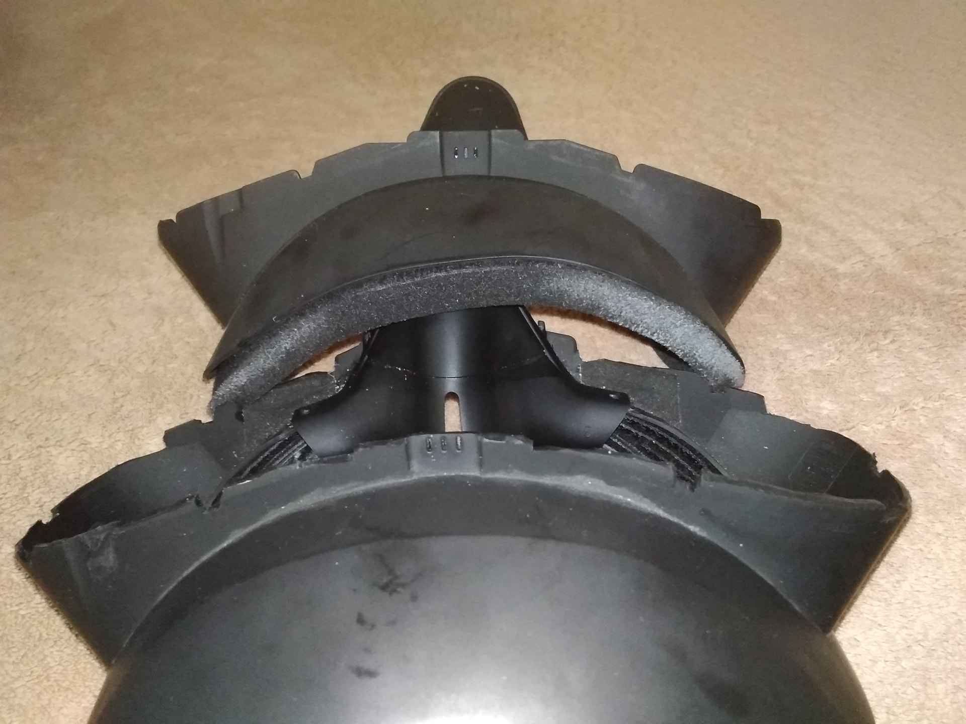

Both masks headset interface from top (notice carving out the space for cable on left top)
Both masks headset interface from bottom
