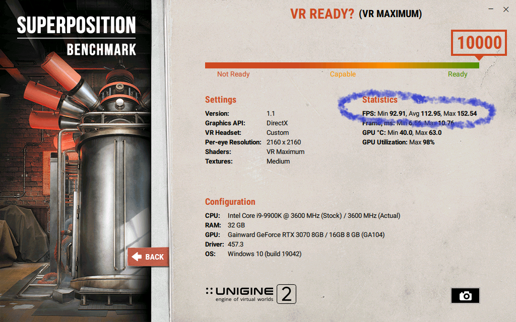

Is a 3070 strong enough for an Pimax 8KX?
Yes, yes it is. Disregard much of the spew already in the thread. People were running their 8KX just fine with a 2080ti, my 2080 does a decent job too. A 3070 will be fine bro. Yes you can do better, but for the same price? MAYBE an RX 6800, it eeks out just a bit more raw power than the 3070 in non ray traced rendering.
