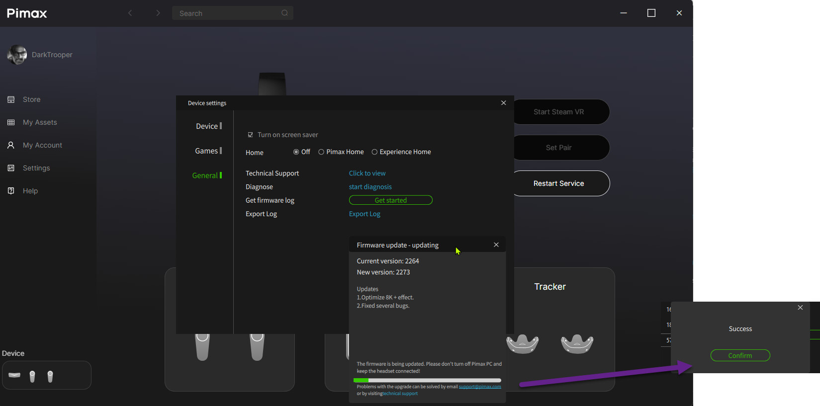

The PimaxClient detected it right away and suggested a firmware update (its been in its box very long). The Update completed but kept resulting in status failed and as mentioned here:
PIMAX 8K - Firmware update process stuck - SOLVED - Pimax 8K Series - OpenMR | Community
it stayed in the loop.

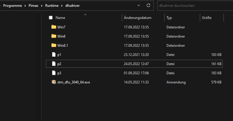

I did find some P1, P2 and P3 without dfu ending files in the Pimax folder
C:\Program Files\Pimax\Runtime\dfudriver
but besides not being sure which one to use for the 8K +
( I also downloaded the P2_RELEASE_M264_t20200508200801_r96b28a3.dfu )

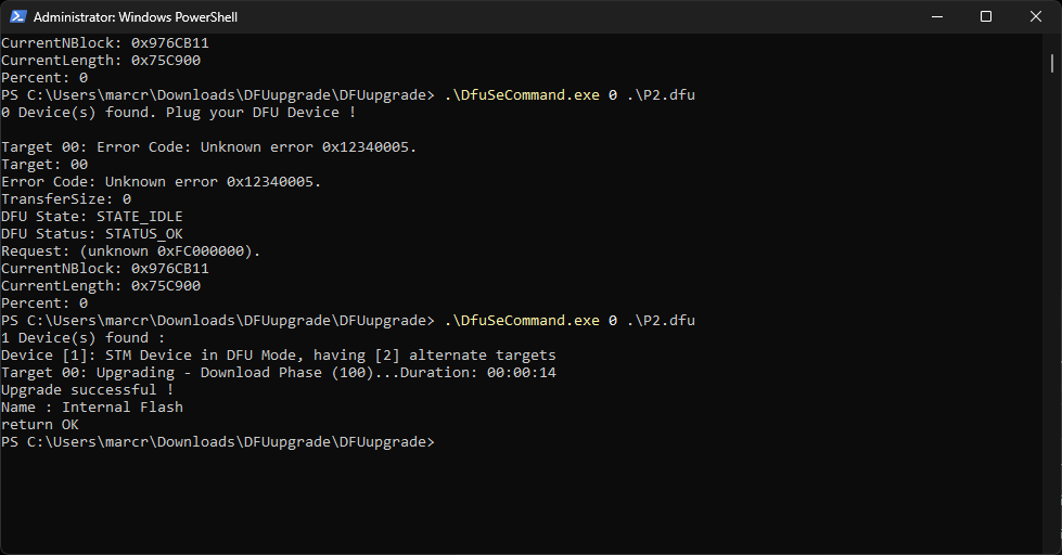

the first problem is that the flashing tool DFUupgrade does not recognize the HMD. (Be sure to not forgett to kill als tasks and services from PiMax (search for those starting with Pi )
Are there any further Tips for getting it “recognized” again? I did not try all USB Ports only the one it worked on initially (so I will be doing that now).strong text
