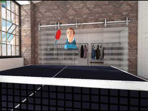

Here is what happens when I leave my 5K+ laid somewhere, with 6DOF tracking:
Ideally there should be no shaking at all.
  • This happens with 2x v1 LH (seeing each other), 1x v1 LH, 2x v2 LH (no need v2 see each other), or 1x v2 LH.
  • LHs firmly attached to walls (also tried with LH just laying onto bookshelves)
  • HMD plugged to usb3 or usb2.
  • Each time the LH is/are visible from the HMD.
  • happens with both my first KS 5K+ and RMA replacement (sn203)
  • I was not able to improve this by making other faces of the HMD face the LH(s), nor by trying to remove any reflective material nearby, nor by trying to move the HMD to another place within the area covered by the LH(s).

I’m not saying I don’t trust you or other people claiming they manage to get “pixel perfect” LH tracking, but I’d like you make a video like mine then, HMD laying somewhere and a very close (few cm) virtual object showing it doesn’t move at all (+ moving controller in the background to prove not fake^^).

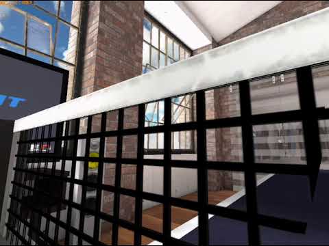

I have done even more strict test:
I have used 2 big cardboard boxes to create a squared tunnel (approx 1.2m x 50cm) to isolate completely both the LH and HMD from any possible reflections interferences.
The wooble/shaking is still there. Interestingly it is there with the OG vive too but much less pronounced than with the 5K+.

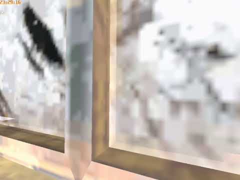

Finally I have also tested the 5k+ in 9 axis mode (= no LH, only using internal gyro) and only with that I obtain a (almost) pixel perfect tracking like I would be so happy to have with 6DOF (LH).
Here are the video captures of the tests:
OG vive + 1x v1 LH fully enclosed in cardboard:
5K+ + 1x v2 LH fully enclosed in cardboard:
5K+ 9 axis mode:
