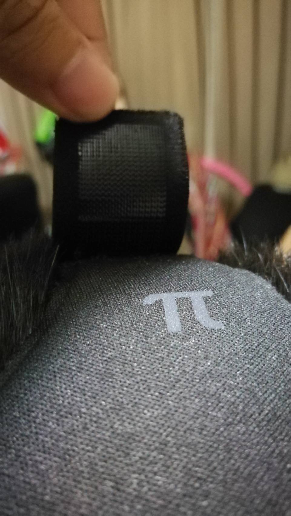

@glassy99 How do you think about head strap when you want to tighten the strap?
Top strap velcro is very loose. The velcro is is too little. I felt the Pimax was pretty loose most of the time, so it was hard to keep it in perfect position.
Thick VR cover helped make it tighter.
I never used DAS, but overall, the straps and comfort are still ok.
Maybe pimax don’t need to make velcro to cover the logo, lol.
