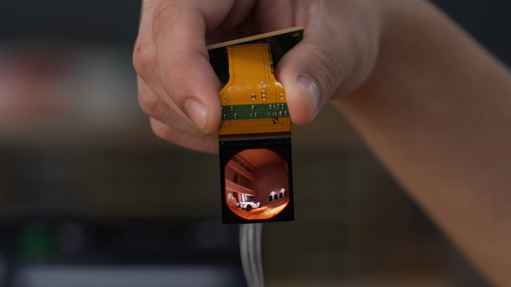

The 4k uOLED panels already exist, from a company called eMagin. The project name is âsteamboatâ, quite clearly a reference to valve. I can send on more info later, just at work.
More info here: eMagin Presents 4K OLED Microdisplay On 'STEAMBOAT' Board
Iâm not questioning where the panels come from just your assessment as to the resolution being 4000x4000. I highly doubt thatâs the resolution Valve will use.
I was just sharing information that is going about, not stating it as definitive.
Why do you think that wouldnât be the resolution Valve go with? How about Apple?
I donât think itâs the rendering target but I do think itâs likely they will be using those 4k per eye panels, it has been strongly implied (look into David Heaney, I think it was him, asking eMagin directly in person and their response).
