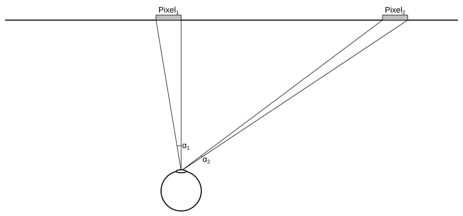

Then; The amount of peripheral vision that is left, when one have one’s eyes swivelled as far as they can go, to either side, and which the fovea can never reach, is probably a larger arc than one may think, and on top of that: That content is already grossly oversampled, relative to what is in the detail-favoured centre of the view, due to its being so far out to the side, as demonstrated by this picture, from one of doc-ok’s articles:
Notice how the angle α2 is much sharper than α1, whilst the pixels are the same size - you would easily have rendered half width out there, and then fit the result into two pixels, without losing angular resolution, compared to the forward part of the view.
…and this begins to happen already within the limited FOV of the Rift and Vive, which is why you can do “fixed foveated” (or any of the many other names the same concept goes by), for those devices - you should not notice much, if any, reduction in detail, when turning your fovea toward those reduced render-resolution edges.
The compositor’s lens counter-distortion also compresses detail out toward the edges, which constitues waste, Some of the rendering and lens effects even out, between them, others do not :7

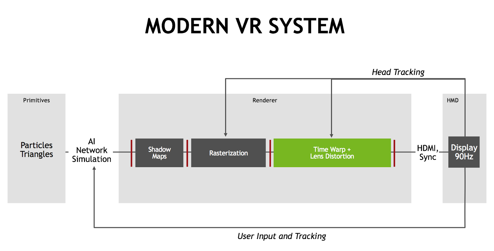

In Unity, if you setup a VR project you get two cameras in scene.
This is roughly what NVidia consider a VR render pipeline:
You can read the full article here:
Oculus for example states
“The Oculus Rift requires the scene to be rendered in split-screen stereo with half of the screen used for each eye.”
And I assume all 3D engines expect this behavior as you can play existing games without having to recompile support for each different HMD. The driver (I assume) will register itself as a step in the lower level render pipeline to handle its own custom brainwarp and distortion, as shown above in the green box.
