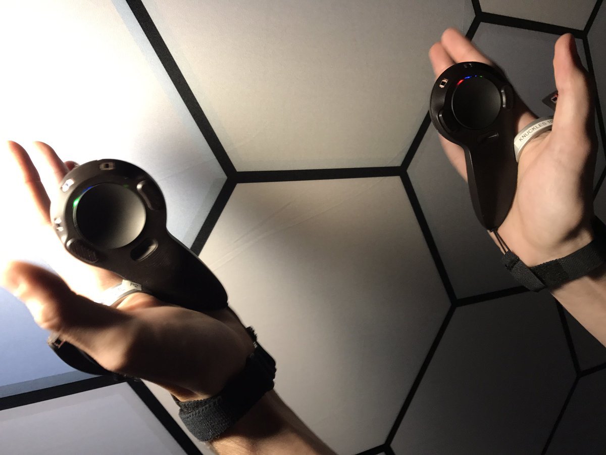

You mention only having to make the grips on the back of the hand detachable. That’s actually a big deal. Those grips carry several sensors , and information from those sensors has to be relayed to the main body of controller. The connecting bridge you will note is made of metal in a product otherwise completely plastic. This was not a vanity/ appearance choice. The bridge needs to be hollow to accept the passthrough of the sensor outputs but extremely strong and rigid. The controllers functionality hands on the rigidity/solidity of the insertion of this part into the main body. what you are asking is to put a structural weakness in the one place the controller has to be absolutely solid. There would need to be a lock in connector with absolute rigidity, with a usb or novel port to facilitate the swap. Can you do it, absolutely. In my opinion is it worth the cost to do it right. no.
And for this you get the ability, that if a controller breaks, you can make the remaining left controller into a right controller and still not be able to play until you buy a second controller anyway.
This is a mindful answer, with solid argument. Positionnal tracking of controller is made in the outer part that wraps your hand. It needs to be firmly stick. Ok.

@destraudo These straps don’t look firmly stuck in order to wrap hands…
