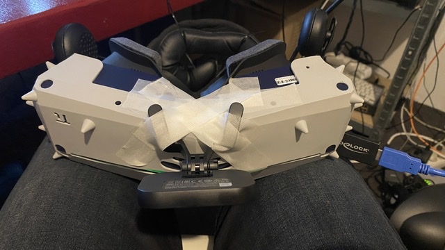

Ok this isn’t really working. The positioning of the facial tracker needs to be rather perfect for it to track. Could get it roughly in place but there was lots of jitter and I only got it to work once or twice.
Really needing a 3D printed adaptor for this but I have no printer myself to start testing things out.
Also tried to use the eye tracker together with this face tracker but it seems to eat my CPU

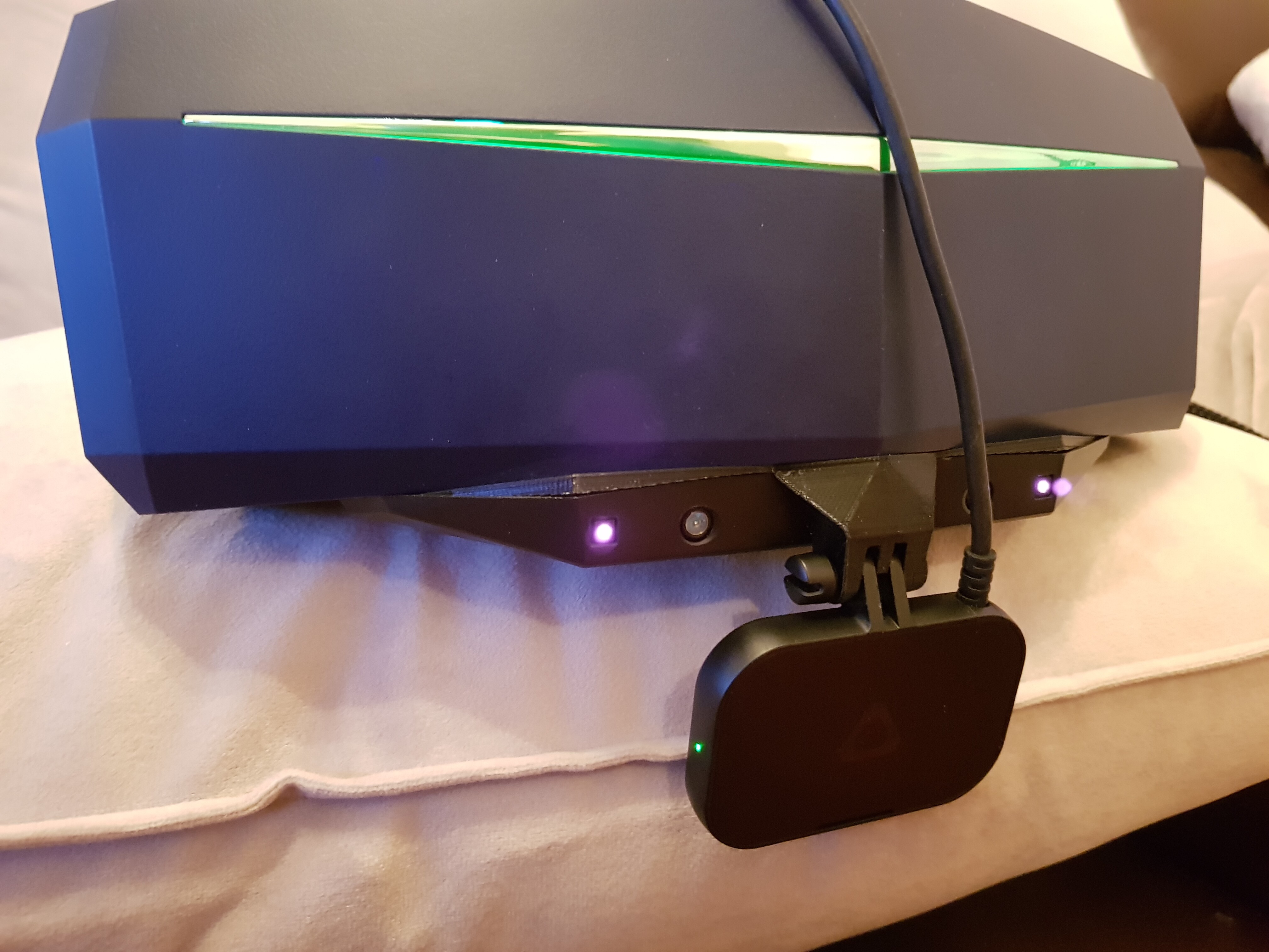

Installation
  1. Peel back the thick black label covering the top of the hand tracking module to reveal the screws.
  2. Remove all of the screws on top of the hand tracking module.
  3. Remove the top cover of the hand tracking module.
  4. Line up the facial tracker mount holes with the hand tracking module holes and screw into the Pimax headset.
  5. Remove the facial tracker from its original mount by unscrewing the thumbscrew completely, and attach the facial tracker to the new mount using the same thumbscrew.
  6. Adjust the facial tracker by carefully tilting it. It is recommended to pinch the hand tracker and facial tracking mount between your thumb and first finger while adjusting the facial tracker to avoid putting unnecessary pressure on the mount.

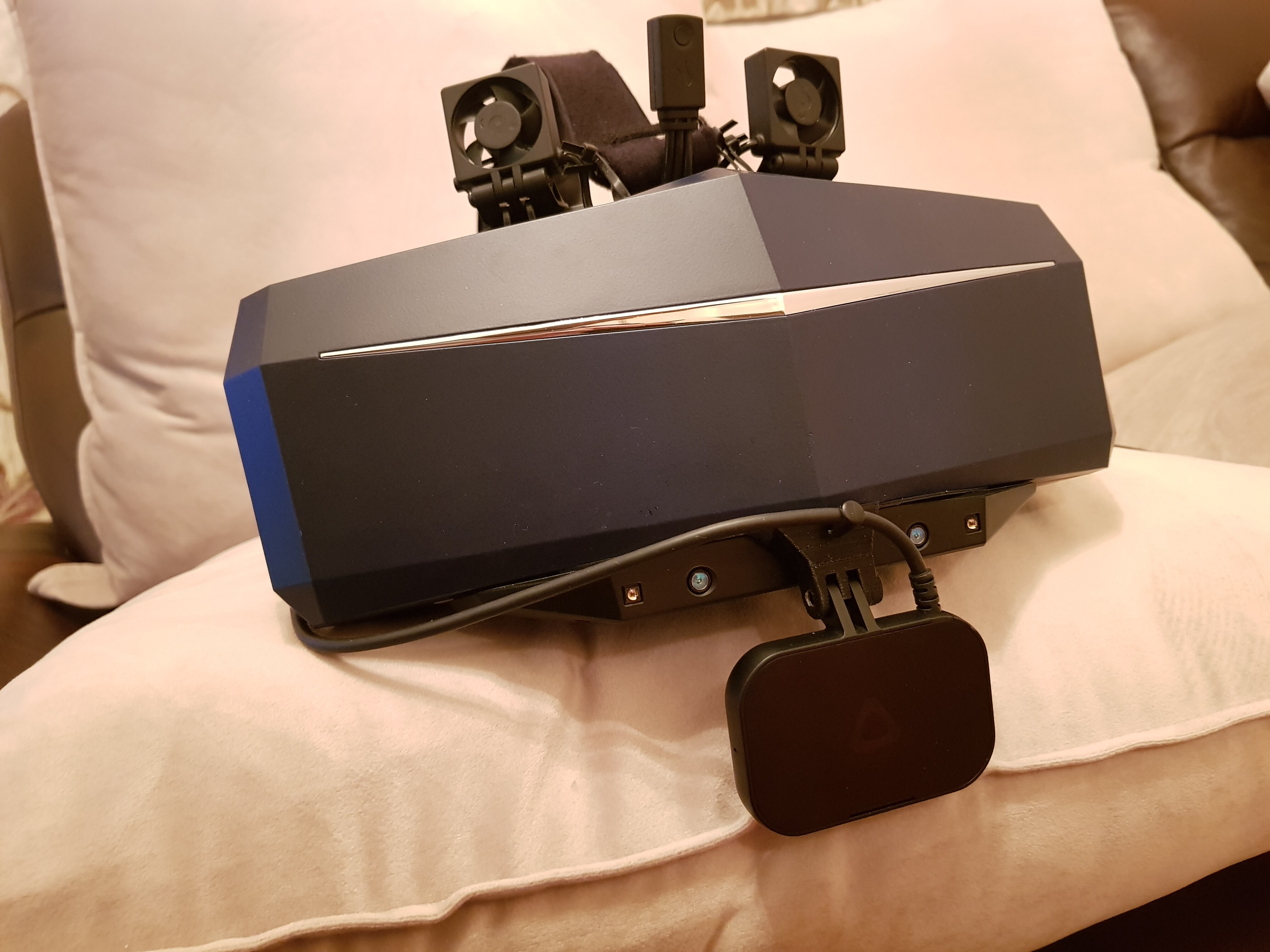

Here’s the first working attempt if anyone wants to try it out.
Note that you’ll need to unscrew the top of the hand tracker module to get it to fit as it was too difficult to get a strong and thin enough version of the mount to sandwich between the headset and hand tracker and have the hand tracker connect without issues.
Nice clean work, but does the face tracker occlude the hand tracker when in use?
Does it work successfully?
There is occlusion with the hand tracker at the moment that affects tracking so it’ll need further iteration to improve it. I barely use the hand tracker so I’ve been more focused on getting the facial tracker working optimally first but I’d like to get both working together without issues.
