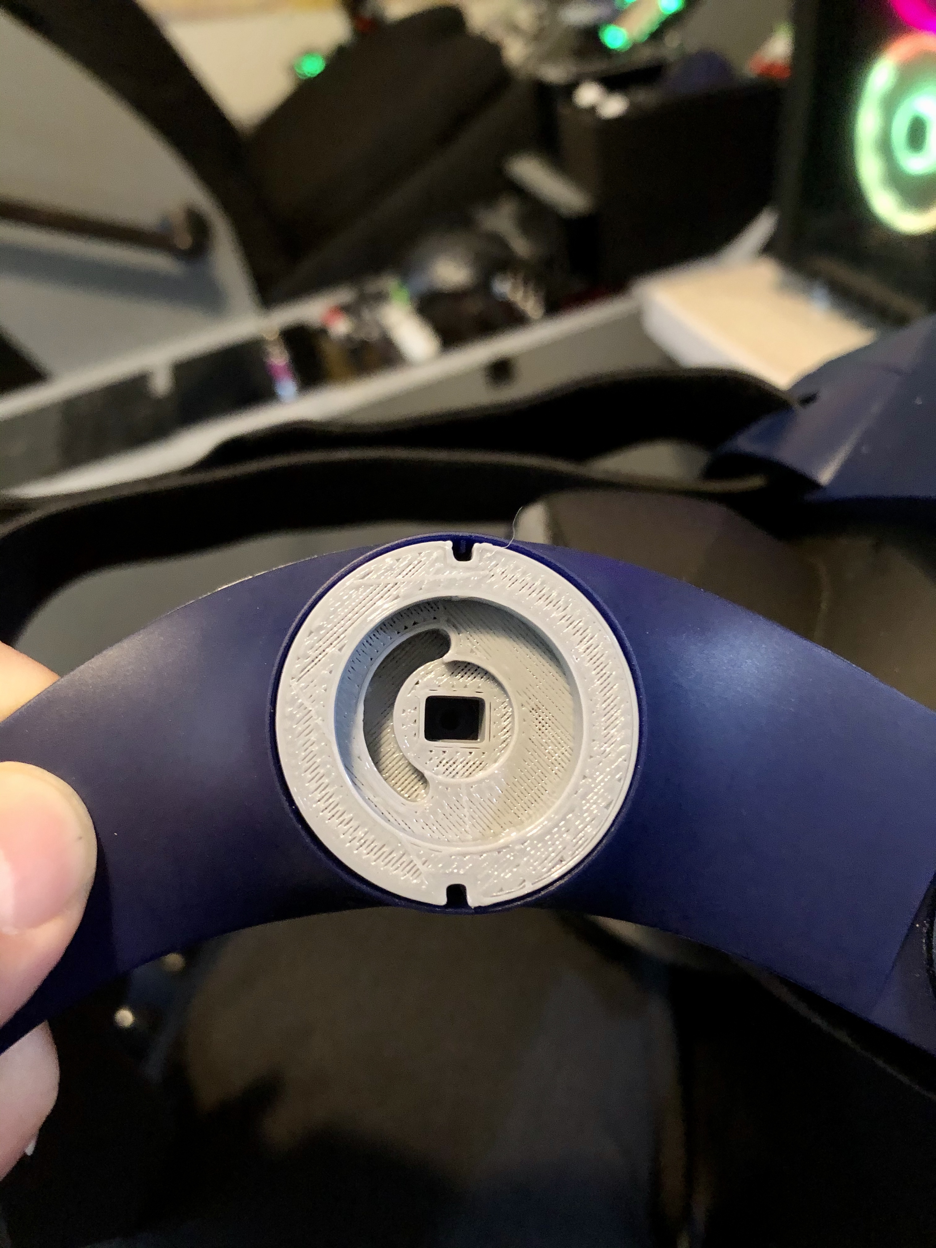

Why not make the spacer larger to fill the side gap? I printed them in PETG and will install tomorrow and Will let you know how it went.
because I have no SMAS & did it blindly

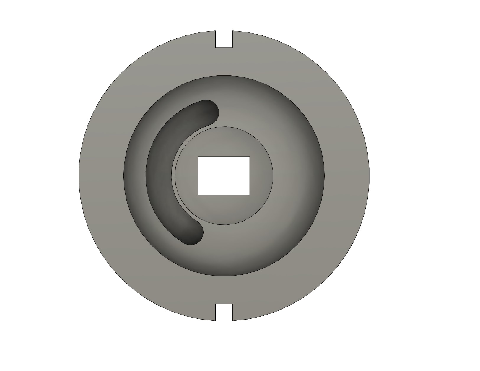

Ok so I started from Scratch and am printing one that should fill the gap and allow for proper placement. First print will be done soon and will assemble if it works.
Ok first test came out nicely and I like how it works - made a very small adjustment for the next print and will complete the install.
Ok so I have them where they tighten nicely with no wobble, and they stay where you put them. The sound if much better but I do not like that they don’t make it to the middle of my ear. For fun I have sound some inexpensive ones that would work if I make an adaptor for them but until then, this is much better sound.
Mind sharing your 3D printed file so I can get this produced?

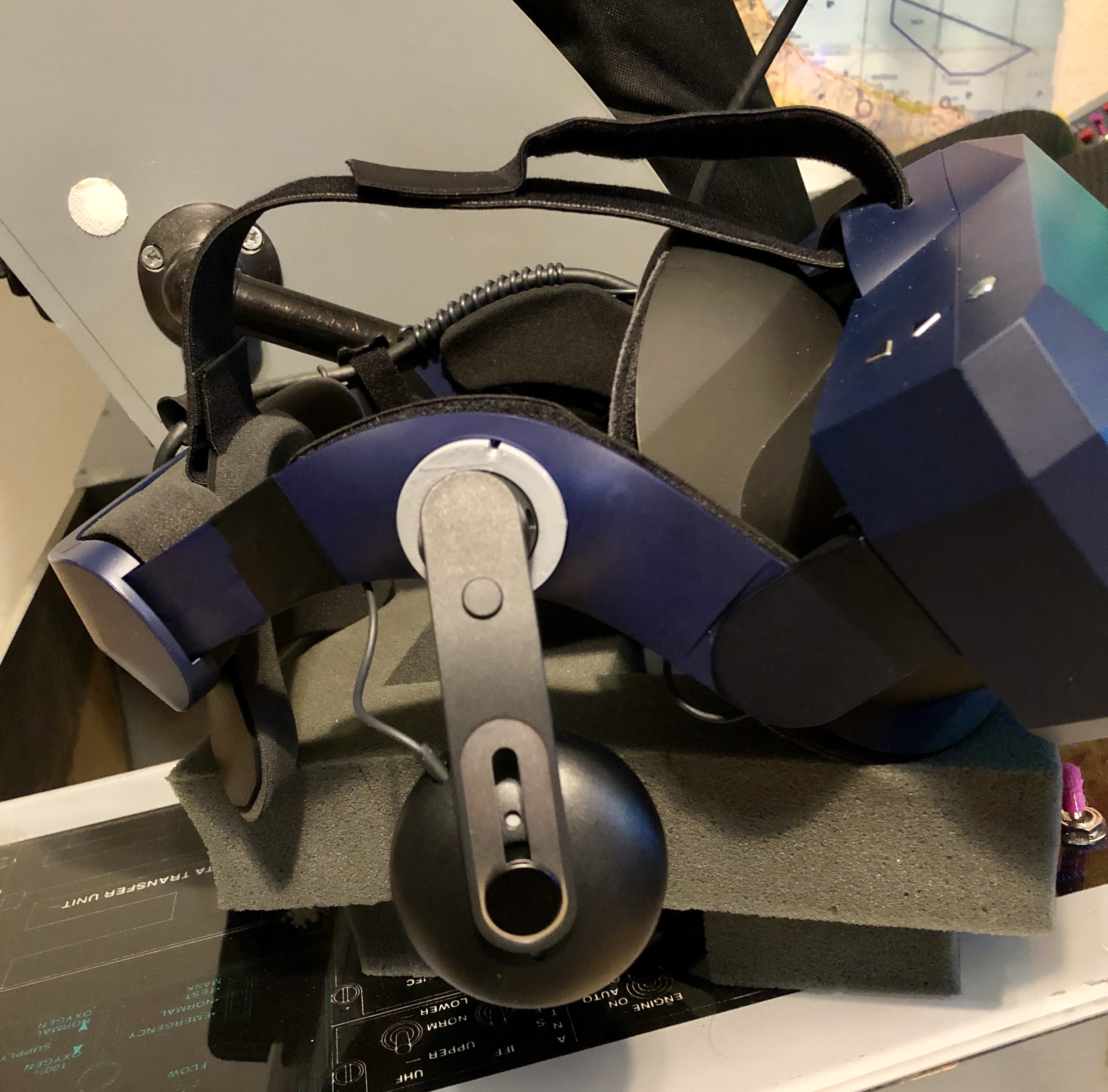

Just got this uploaded as a remix ! Tested and it works - but I will be building a mod for a different set as the speakers do not fully reach the middle of my ear. But, they still sound much better than the originals.
Here is an update on a bit different speaker setup if you do not own a DAS. This is a less priced way to go and it fits closer to the middle of your ears.
