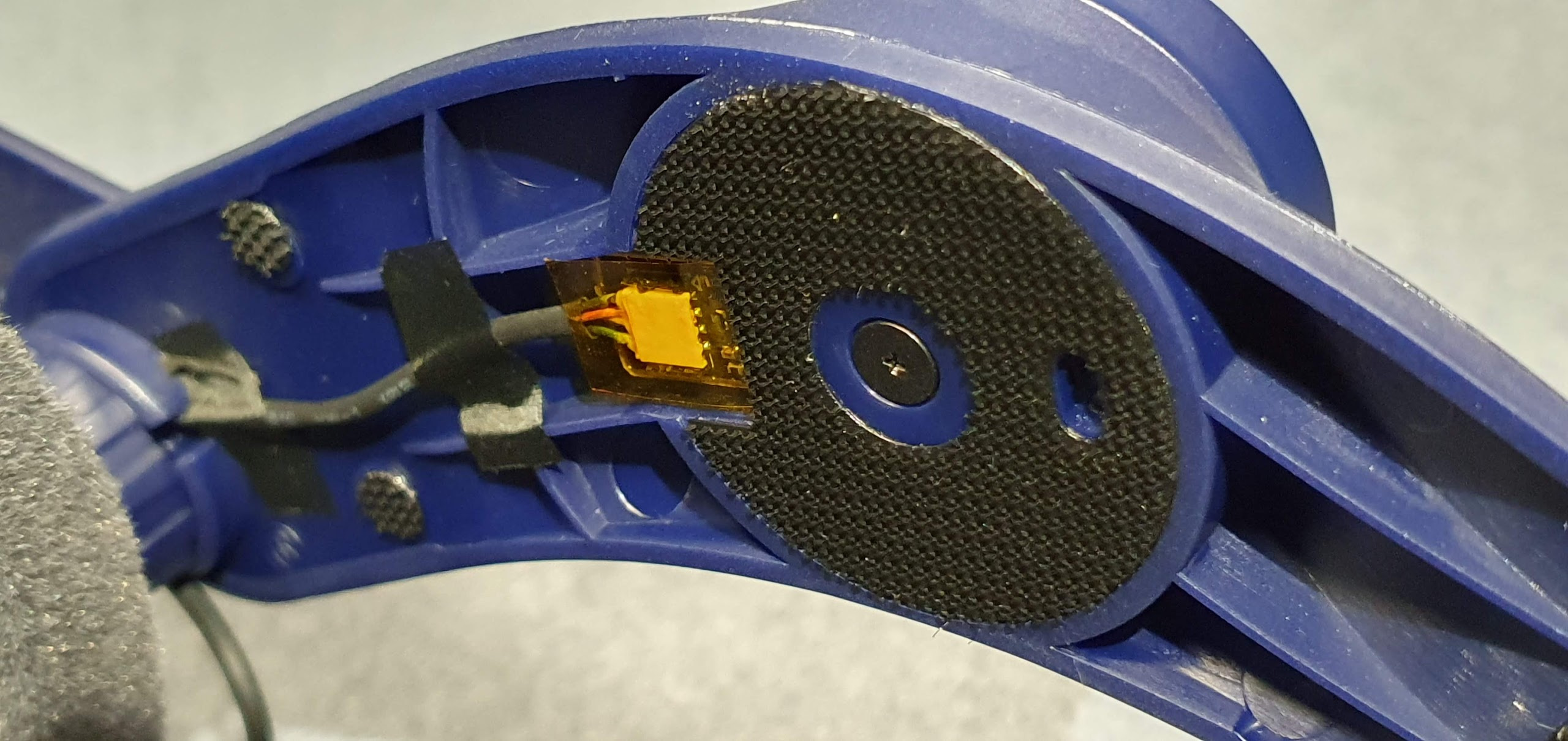

Removing the SMAS speaker is very easy: you need to peel off the foam padding on the sides, and this will reveal a single screw holding the speakers in place:
I have to give it to Pimax, these really are modular: all you need to do after unscrewing that single screw is pull the speakers out:
They pop out very easily:
Be careful not to lose the original screws - my solution was to screw them right back in to the speakers which went back to the 8K-X box:
