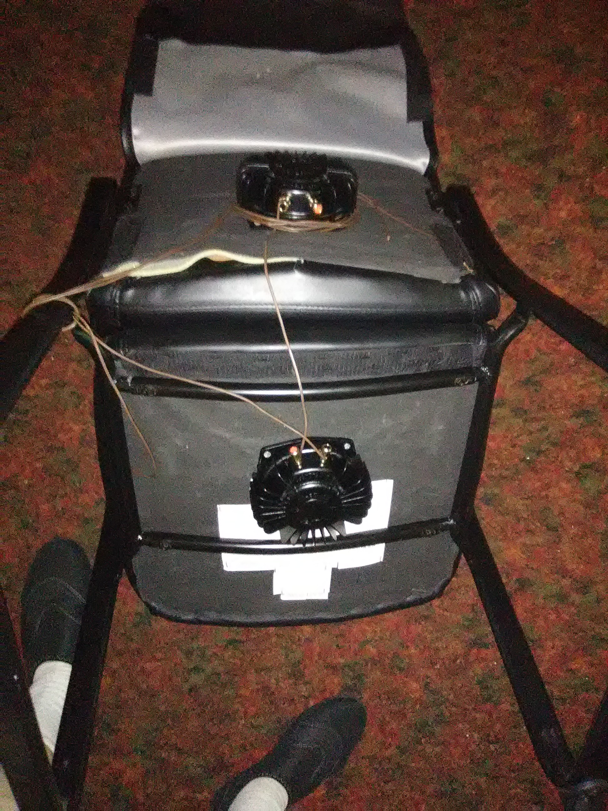

I didn’t bother posting my flight setup but it includes the same table and chair and another end table. Ugly but I’m inside and can’t tell,
Hey at least i spent money on the transducers and that i can feel inside.

how is the strength of the feedback with those style of transducer , I have a buttkicker but i was forced to dream up my own mounting solution since i’m not using an office chair
its a flange and pipe from home depot initially i just screwed it in there but it would wiggle loose with vibration. Then i put some Loctite on the threads and its basically welded secure.
only issue is that vibration doesn’t seem to travel through wood as well as metal.
I 3D printed some ABS brackets and mounted my buttkickers to the IKEA Markus arm wrest mounting point and applied wd40 to reduce squweeky noises at joints which is effective but a chair without any moving parts would be ideal.
Furthermore the plastic absorbs some of the vibration when it flexes but it works to my advantage because even a single bk advance is overkill for a chair and the plastic flexing prevents the chair joints flexing and making noise, the plastic bracket is locked in place with bolts and nuts and blue thread locking glue which can be removed
It is removeable and does not flex when you have enough contact surface area at each corner and the sides.

The transducers are overkill but great, I put one on each side to balance it out. Amp is mono unfortunately but I am willing to bet I won’t notice any difference.
Initially I only had 1 bass shaker but opted for a second once since it overheats under load from sustained engine RPM effects 30 minutes in. By having 2 BKs I can lower the gain for the same tactile response due to constructive interference whilst keeping the thermals low enough for the transducer to be passively cooled.
They’re 50 watts each and mounted flush to the wood in the chair. I actually chose the chair because of it’s wood structure for the purpose.
Sufficient strength off a 110 watt Sony amp.

The BK4-4 transducers in my earlier photo are 400w max rated each
That mount is able to handle it but it gets scary on certain frequencies for a long period of time at 300W and above so some effects have to be toned down in simshaker.
I run them at 200W each since it doesn’t overheat that way for Sims, for music I crank them up to 300. They are decent for music but there are better options for that.

My original BK1 would over heat and cut out. It eventually died. These Aural Bs stay cool to the touch all day. I had considered adding 2 more but 2 have been more than enough shake.
