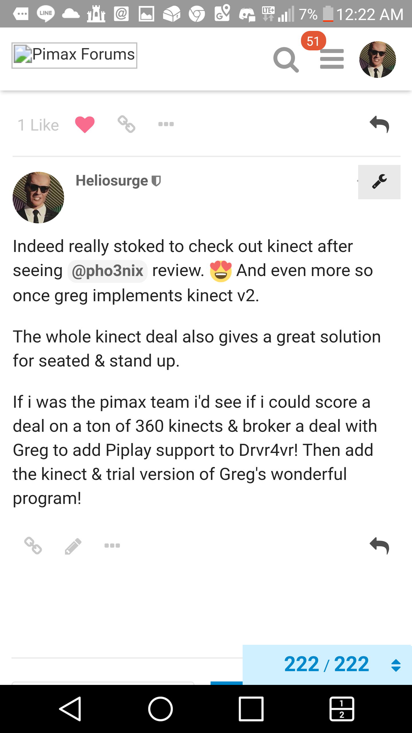

I would recommend getting a hold of the Creater of Drvr4vr as he looks to have a posdibly a way to add plugin managed support to piplay as he has done great work ti steam.
