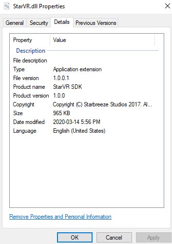

starvr-1
The DLL was made from the StarVR SDK and it’s version 1.0.0.1
It has a copyright of 2017 which leads me to believe that is when the dll was first added there.
Maybe the dll is too outdated to run properly on the latest project cars 2. Perhaps you need to download the latest StarVR SDK and replace the dll with a newer version.
Also I can see a bunch of function names in the dll by using this tool:
I think the easiest way to tell whether the StarVR.dll is being utilized, is to delete it and then run the game with the StarVR headset. If the game doesn’t run, then you’ll know the dll was being utilized.
