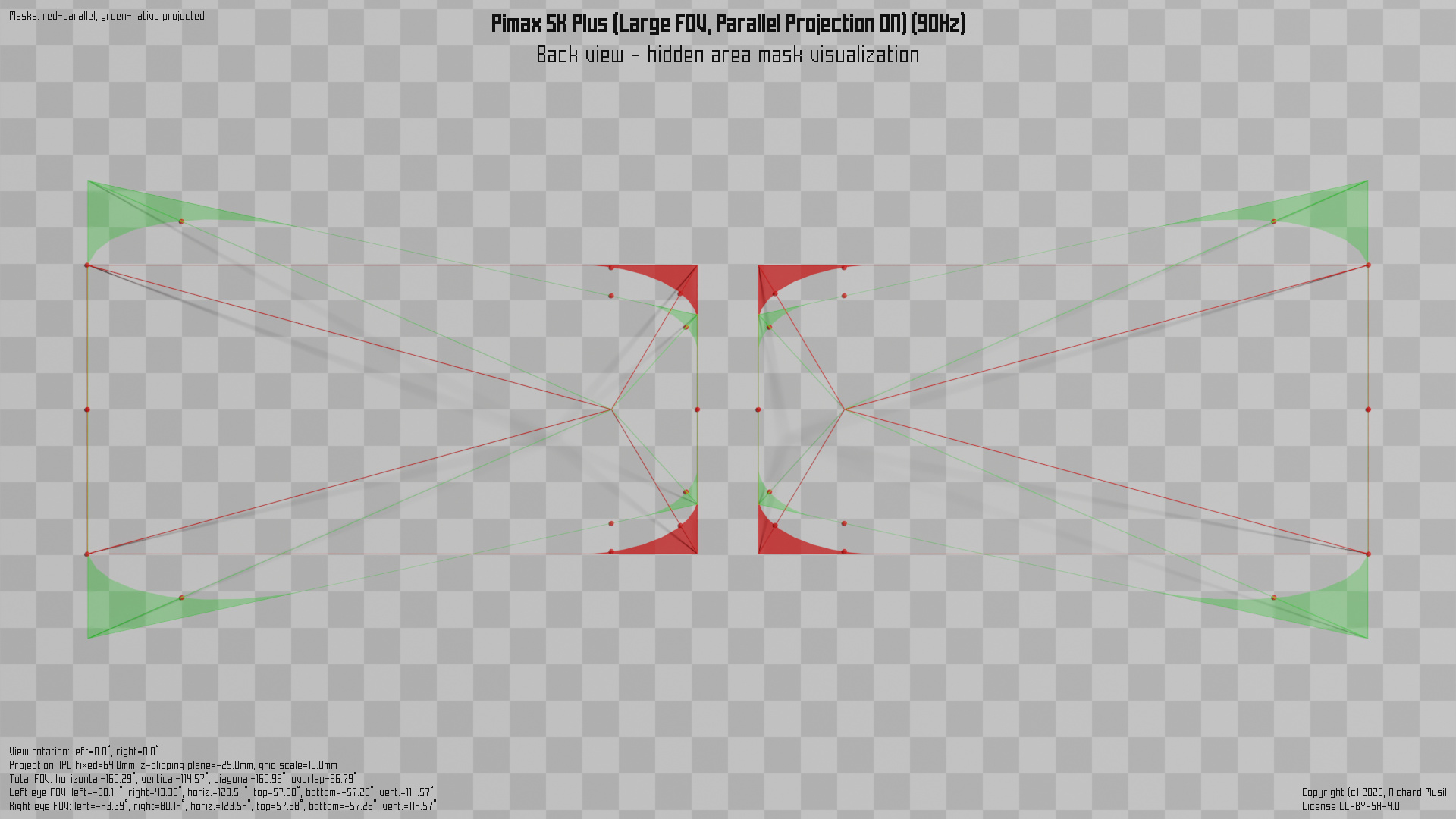

The original HAM on Pimax 5k+/8k in Large FOV and PP on looked like this:
The new one for 8k+ looks like this:
and for 8k-X even like this:
The green shape is the projected HAM from the native mode (for comparison) the red shape is the actual HAM in parallel mode.
Theoretically, the “inner” shapes should be aligned (as I visualized it in my post about the HAM mod), but here the red is limiting the FOV more than the green one, which does not make much sense (as per point 2) above).
So either the native HAM is not defined correctly (and masking less than it should) or the red one masks more than it should! I guess only someone with the headset can confirm that, by looking into the same scene (or using RoV tool) with parallel mode on and off and comparing the visible vertical FOVs. If it does not change then the native is still a “bit loose”, if it does change then the PP HAM is too restrictive.
The discrepancy is somehow present on all types of FOV in the new headsets (they are probably on the old ones with the new firmware too, but I have not yet verified it) but in a different manner. (You can easily compare it by looking at the different HAM images for different FOVs in the database).
It seems that Pimax created a new HAM for the parallel mode and then used the same mesh in all FOVs, which, as the visualized projections show, does not work, because the projected HAM has to be calculated individually for each FOV (basically the way I did it in my mod).

The rendered visualization takes into account the same information the application (which renders the scene) has, i.e.:
  1. The advertised FOV
  2. The advertised HAM
The application is supposed to render the HAM into a stencil buffer (or whatever) and then render the scene defined by the given FOV.
The only thing which the visualization does is that it displays the HAM from the native mode projected into the same plane as the HAM for PP mode so you can compare the two.
It does not need to do any side-guessing about what Pimax software might do with the rendered image later, because it is irrelevant. It has to respect the FOV and the HAM provided by the OpenVR API.
Well, my post, while already old, is still valid :slight_smile:.
If you are interested in how I did it: I rendered the native HAM (in the corresponding FOV) and projected it into the parallel plane. Then manually in Blender defined the HAM which matched the projected shape while respecting the original FOV. Exported the mesh, transformed it into texture UV space (in which the HAM is defined) and used my debugging filter driver to inject the HAM into OpenVR runtime instead of the one from Pimax driver to test that it works. It worked.

Actually, what you saw should exactly match the HAM shape. The only thing, which may look differently is the shape of the HAM in PP off mode, but this is because what you see in the screenshot corresponds to the rendered image + HAM shape in canted plane.
In other words, what you see is correct.
