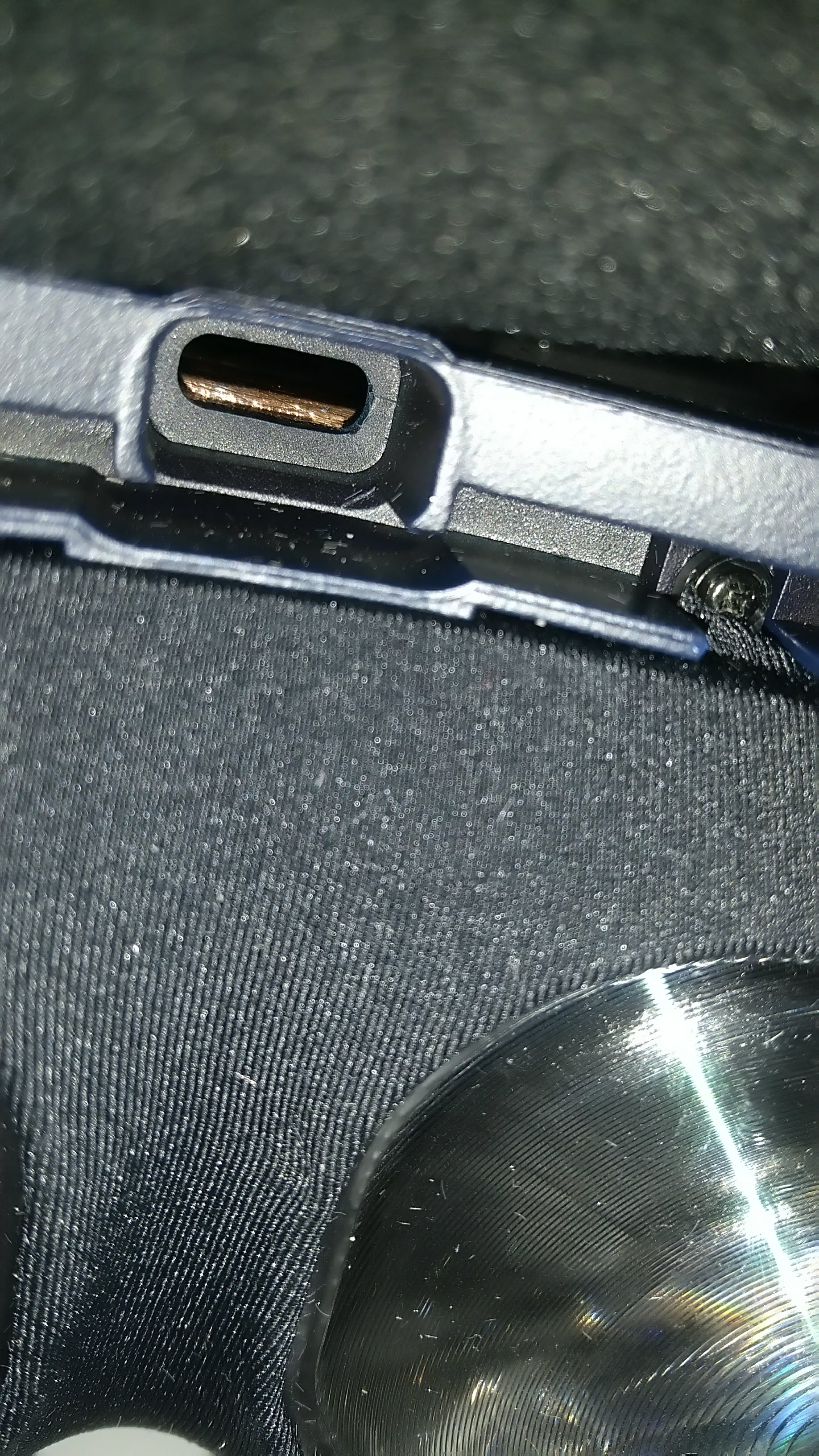

I received the new cable, three weeks after having received the tracking number.
It seems to work.
Now I tried to mount the eye tracking module, andā¦surprise !!!
No usb port
Thereās no top USB port on the 8KX:
https://community.openmr.ai/search?q=No%20top%20USB%20port
I donāt remember the exact reason but I believe it boils down to the PCB being bigger on the X.
If You search for it is there, somewhere⦠![]()
You should have a cable that allows You to connect it to the bottom USB port.
There is an included usb-c cable to connect to bottom on the 8kX
