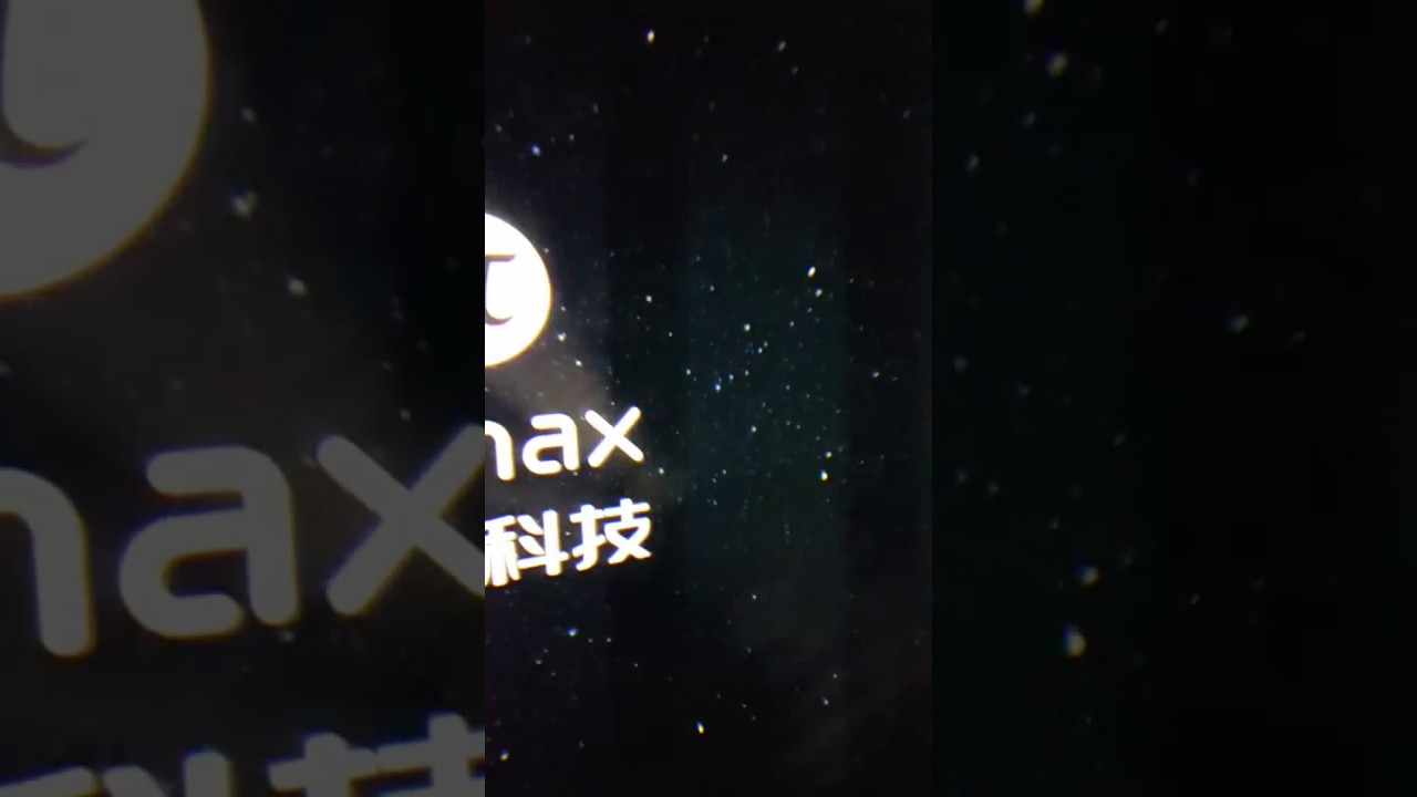

I’ve just received my loaner 8K today and after the usual game of service restarts, folder deletion to get it tracking, I noticed a serious problem with the panels:
There is random pixel noise all over the screen, with the screen flashing every couple of seconds. I tried the following without success:

That was a great tip! I managed to pull out the 8K’s cable and plug in the 5K cable instead - the screen now works flawlessly.
Also the 8k cable refused to work in 2 out of 3 of my Displayports (and was noisy in the working one), whereas the 5K cable works in any Displayport right away…
So we have a winner here: it’s a defective cable. I’ll update my support ticket - hopefully Pimax can ship me a replacement cable only.
