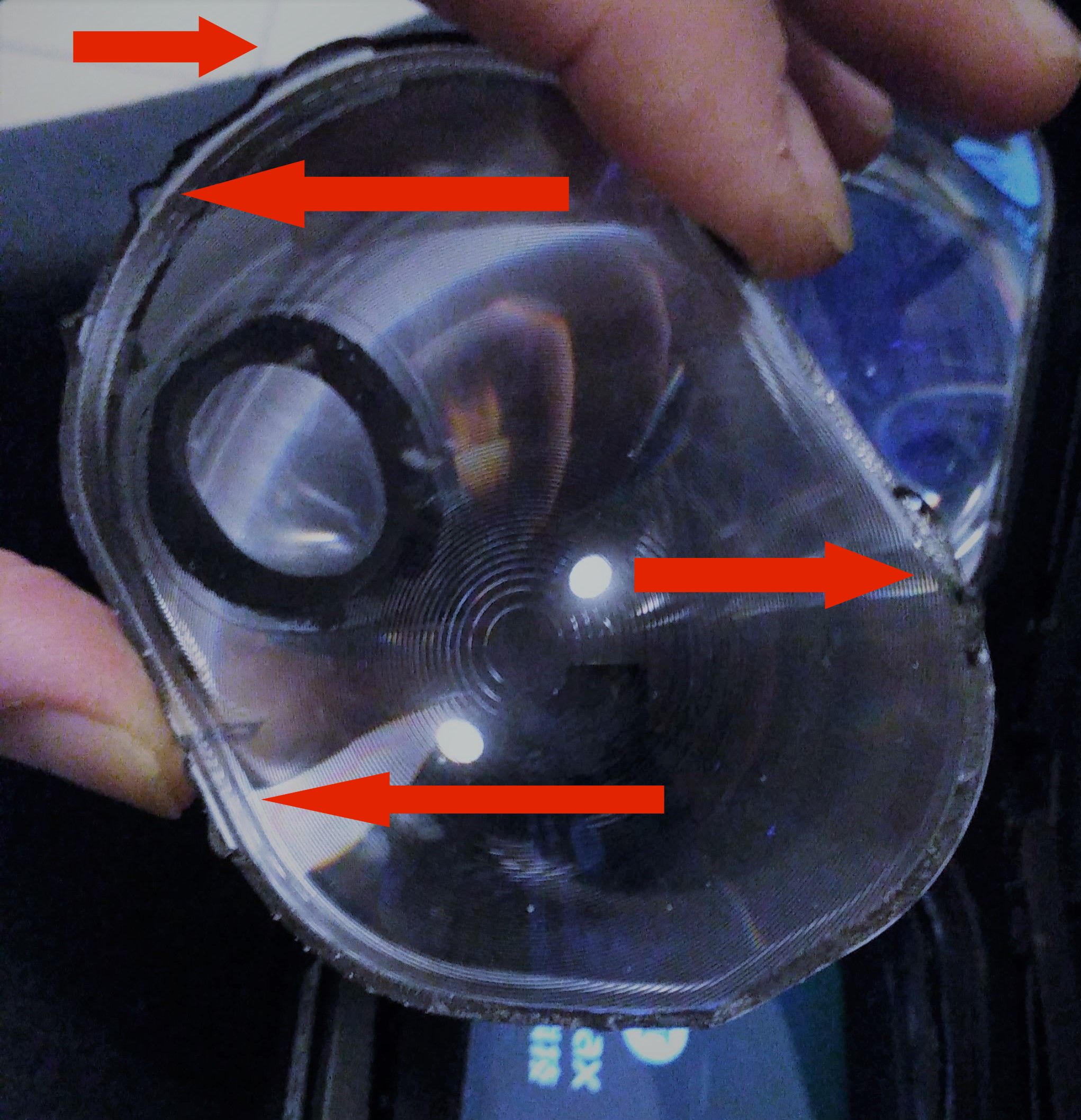

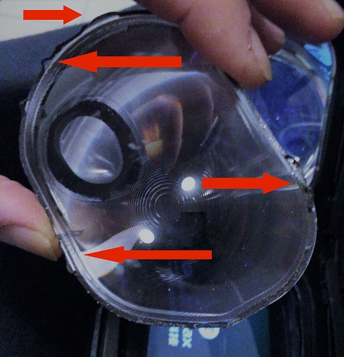

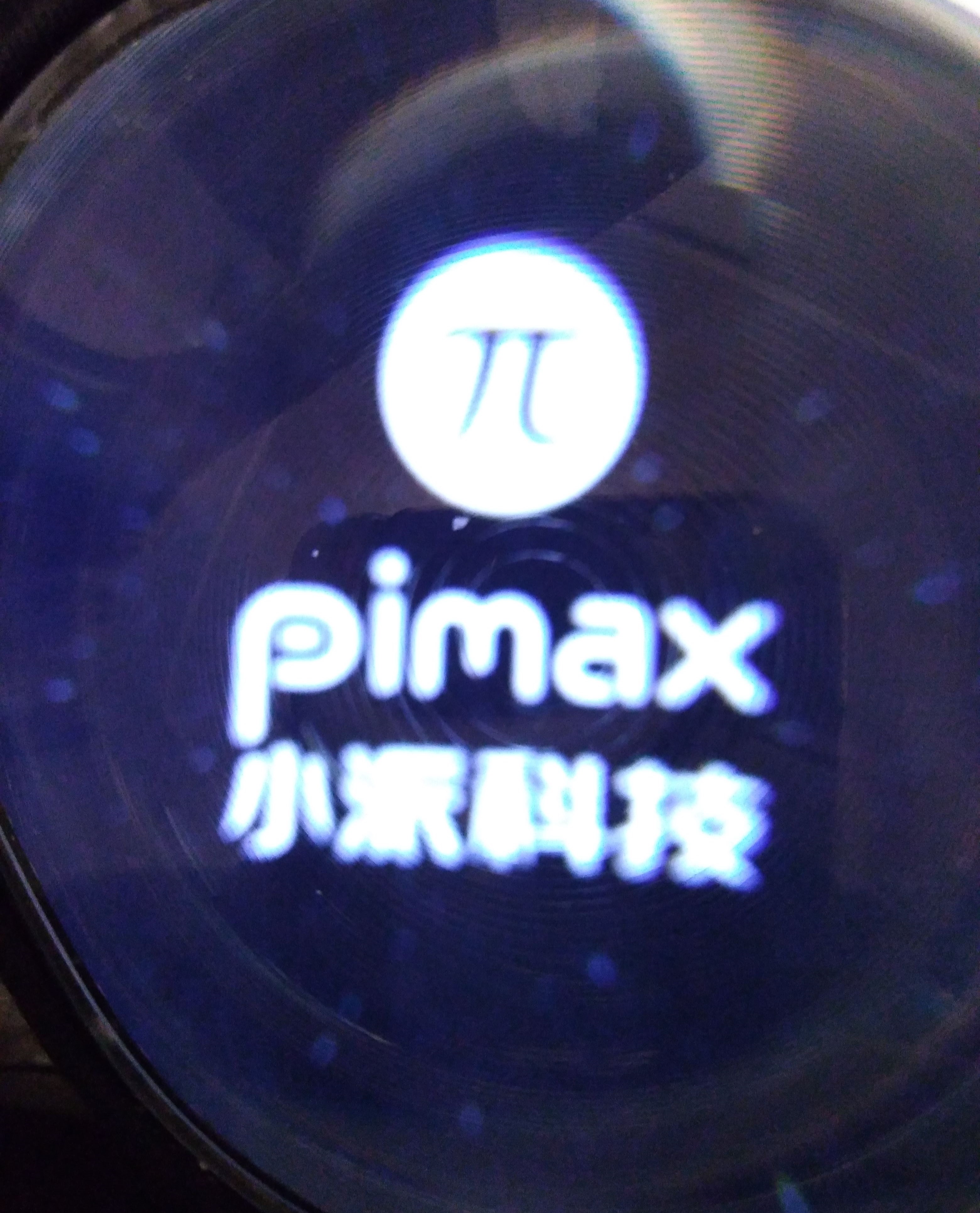

Today when taking my hmd I noticed some huges dust behind a lense and right in the sweet spot :frowning:
No other choice that to remove this.
I checked again @SweViver video when he shows how to remove them and thanks to him for this :slight_smile: but they are actually glued and some glue on the edges can peel off and stick somewhere we dont want on the lenses.
So, have to be carefull when removing the lenses and it doesnt come that easy at least for the 1rst time !
And as you can see on the second picture, a wonderful (it really bugs me, I could remove the lens again just to see this, since I noticed it later on picture) optical effect that make my sucion cup mostly…invisible !

Yeah the vive lenses also have a certain amount of glue, when I did the gear vr lens mod on both of my Vivers I experienced this but it was very trace amounts holding the lenses in place and there really was no risk of glue residue falling on the lens. Made my experience with the Vive so much better.
thanks @Ludiks for the heads up and warning though for anyone who may consider removing the lenses in the future, they should be careful.
@Ludiks do you think the dust was already there or did it get in recently?
While the lens was removed, you should have taken pictures of the screens pixels!
I think dust got in recently.
Yes I could have take pictures…maybe for the next eye ^^
Make sure you clean the lenses with some good soap, because the glue is very sticky and if it has touched the lenses it’s difficult to remove. So be careful
Do you have to glue them back again? Or do they sit snugly enough without the glue?
That’s odd. I did the same upgrade on my Vive and there was no glue. Either way, it was an awesome upgrade and it finally made my Vive worth using.
Rev
Since glue was still on it, it glued itself back yes
Yeah I have removed all glue and they have stayed in place.
