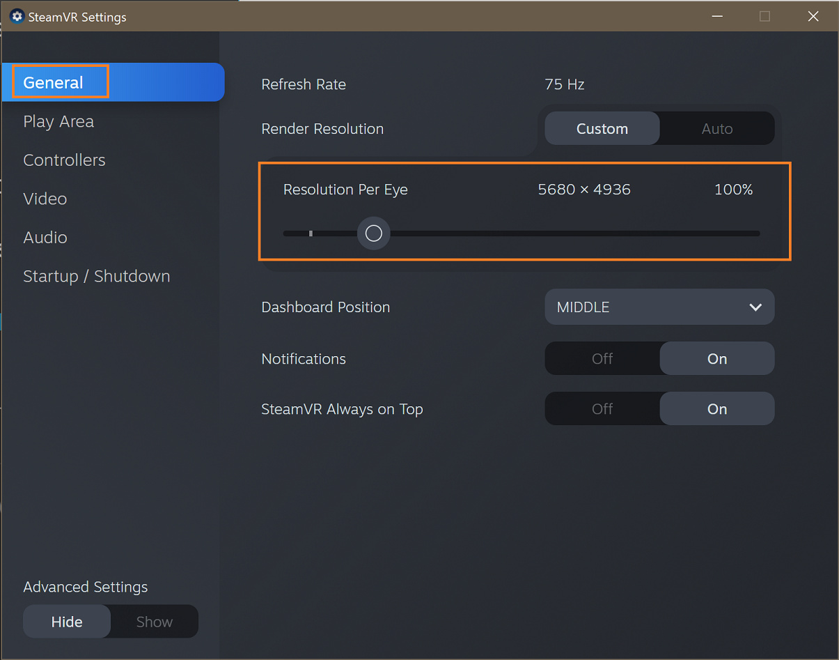

I assume SS stands for “supersampling” here. Can you advise where Steam SS can be set? The only reference to “supersampling” I can find in SteamVR’s settings is something called “advanced supersample filtering” (off/on).
There is something called “supersampleScale” in the steamvr.settings file which is set to 1. Is that it?
The name has changed a bit over the years. This is setting that they are talking about:
Thanks! So SS = RR. Got it :wink:
