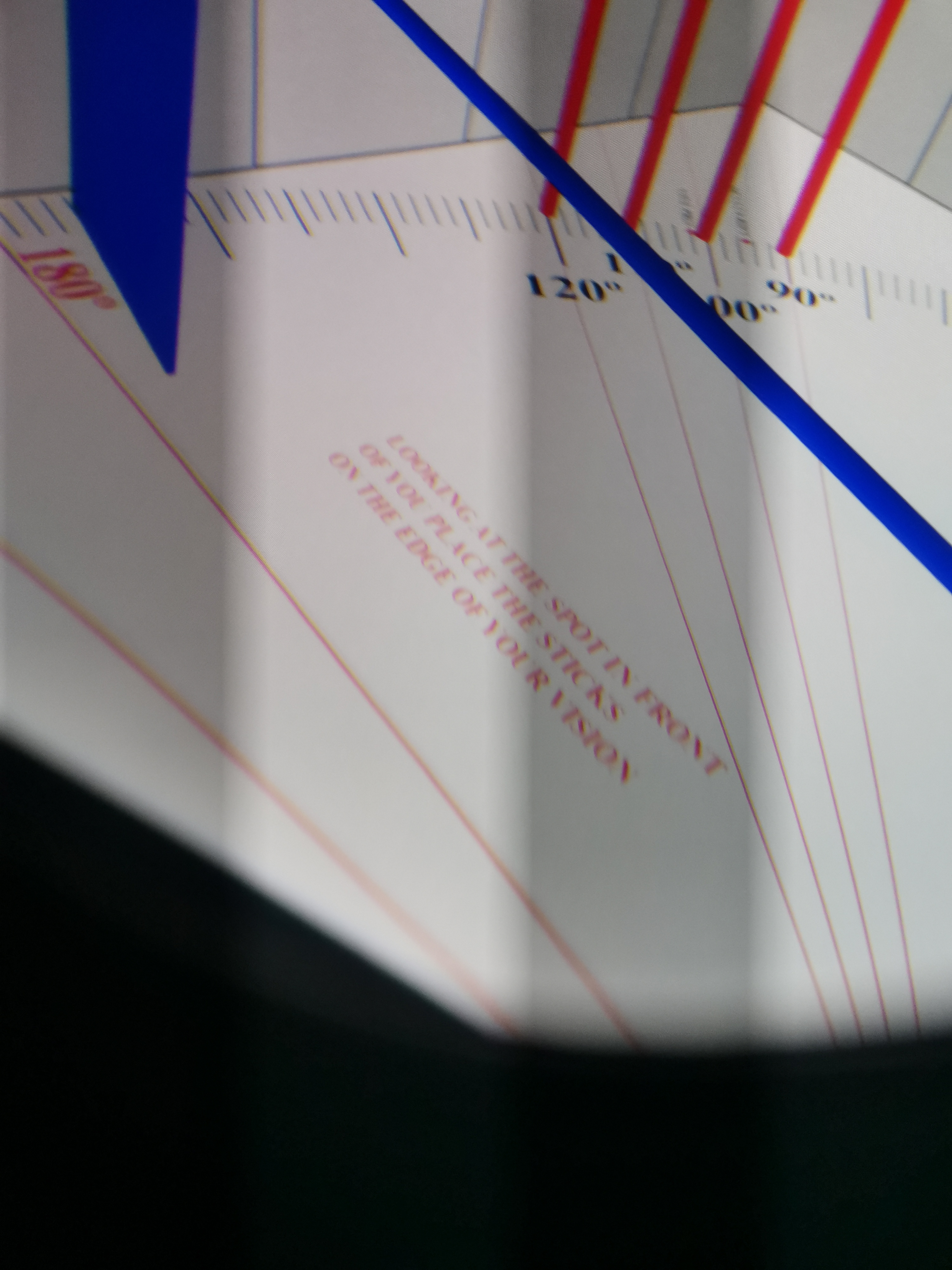

Ok, I just used the ROV test with the pedals and always manage plus ~~180+~~ degrees with the 5k and the 8k+.
But that might be worth a check with Risa’s tool that I wanted to do long ago.
If the rendering is actually at 121, that could mean it’s due to a PiTool Version thing or also IPD related (?) if it should do more in theory.
What IPD do you have (or the other FOV getters )?
EDIT NOT 180 - sorry its 170+

I will check again tonight, but i am quite sure when I use large, take those “red paddles” and hold them they pretty much align on a straight line on the ~~180°~~ 170mark. Its a theoretical value, as I find that to be the outer most value at which I would not get much info out of a game comfortably. Also I did press the HMD in my face as much as possible, more an my nose will be coming out the front again 😉 . But its definitely more then the 160.
I do have a small IPD at about 62 measured and dial in the lowest in the 8k+ and very low in the 5k.
<div class="post-metadata">
**Author:** ![MReis](https://forum.openmr.com/user_avatar/forum.openmr.com/mreis/32/1745_2.png) [@MReis](https://forum.openmr.com/u/MReis)\
**Post date:** [June 3, 2020, 6:19pm UTC](https://forum.openmr.com/t/possible-direct-comparison-of-blue-case-vs-black-case-artisan-fov/28334/16 "2020-06-03T18:19:04Z")
</div>
Ok, I tested it again - and no I am not am 180 ☹ sorry I was damn sure of it.
I get about max 172° using the largest FOV, Staring at the red dot on the floor (not the green one straight ahead), because I can see the lines of the degrees better that way, it might make up for the 2° extra.
At that value I can just still see the blue (not red sorry) shimmer of the paddles at the very edge of the screen.

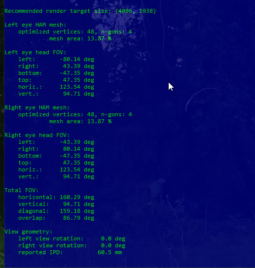

That’s odd. Can you post the output of Risa’s tool? [https://github.com/risa2000/hmdq/releases/download/v2.0.1/hmdq\_tools-2.0.1-win64.zip](https://github.com/risa2000/hmdq/releases/download/v2.0.1/hmdq_tools-2.0.1-win64.zip)
Just start SteamVR and run the tool from a commandline

Most likely I am to stupid to use it right. I do jump on the middle of that circle, but If I do move my head a bit, that would falsify that value.
I will run the tool now - that just be the real value and will most likely be on par with yours… would be strange if the rendering is different.

ah, you’re using the non-commerical version? Yeah that’s not accurate since you can move your head indeed. That explains it then indeed

Yes that must be the reason. Rendering is rendering and I just ran the tool - its at 160.29 degrees.
The error sits before the screen once again - sorry. As my science teacher always said, don’t believe anything you hear and only have of what you see with your own eyes.
