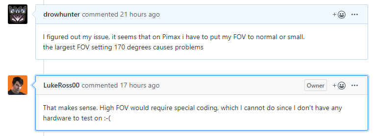

No matter what I do it just doesnt look or work right on the pimax. But every other headset i mentioned works perfectly.
Filed an issue, and he doesn’t think he can fix it as he doesn’t have access to a Pimax.
Link to github, where he tells me to just play on quest

I figured out my issue, it seems that on Pimax i have to put my FOV to normal or small.
the largest FOV setting causes problems
