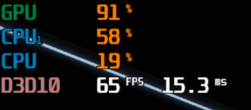

The following are from .280 from the game Lone Echo
Now we all know that if there’s unused GPU - there shouldn’t be anything less than full frame rate in this case 75 FPS as I was running on 75hz
These are from same scene/settings in .263
Voila! 100% GPU use or 100% of Hz in FPS.
Please note that I have also tested this on multiple machines, with differing GPUs and noted the same result in multiple games. It is VERY reproducible.
The GPU is never allowed to reach 100% because it in my estimation has the wrong timings.

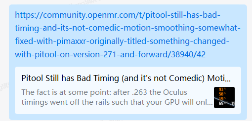

Here is the link to the original issue with Oculus games Pimax Low GPU Utilization on Oculus Games

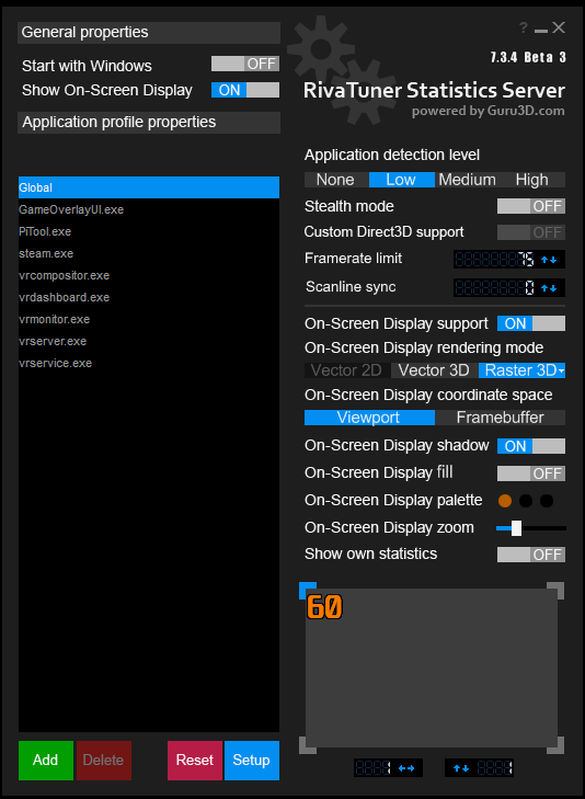

Addendum: If you want to use .263 and have it’s benefits - with the addition of compulsive smoothing : Use rivatuner and set the frame rate of your HMD to that of the frame rate limit as shown below
This provides a fix for the “jumping around display” that was occurring with games such as Vader Immortal and Asgard’s Wrath as the problem was a - you guessed it - timing issue. So now you don’t have to use Revive for Vader Immortal.
The above method can also be used to set compulsive smoothing to half your HMD Hz - so for example if I want 37.5 FPS - I would just put that in the slot for the frame rate limit.
There may be even more utility to the vsync parameter just below it, but it for some reason trips to the monitors’ refresh rate (60FPS) whenever I use that.

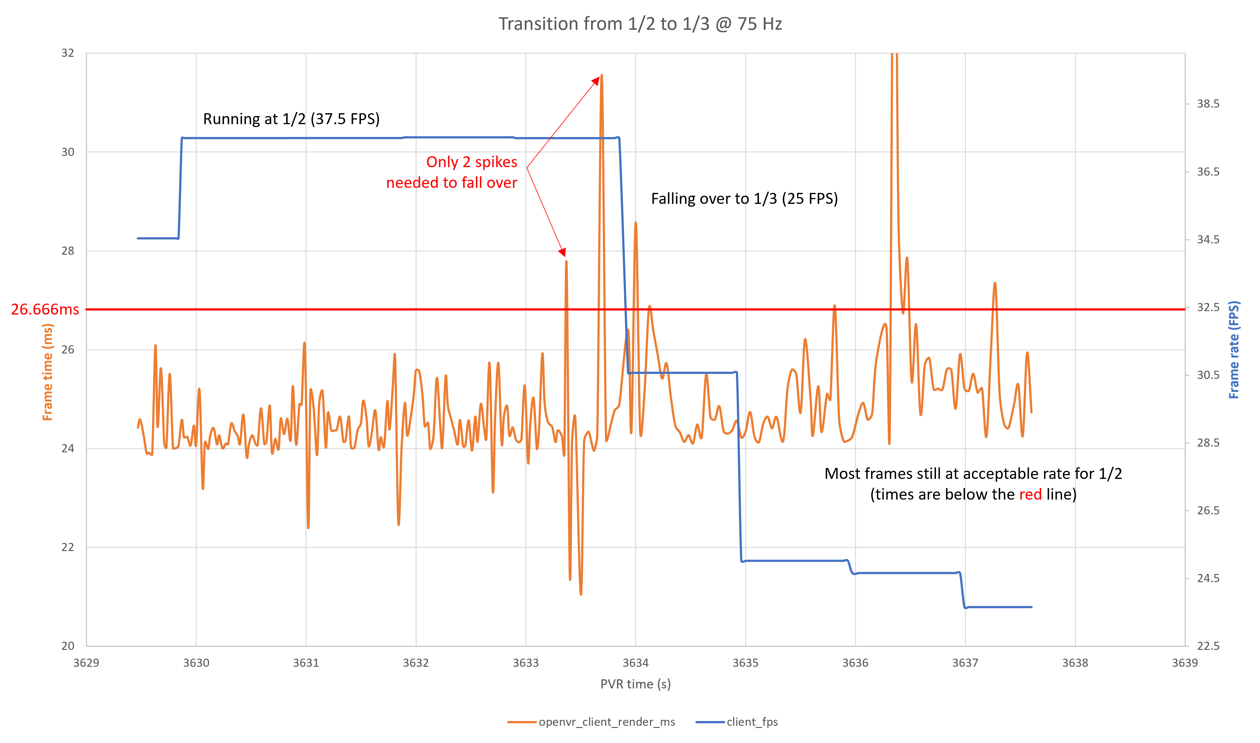

Replying to myself: it looks like the numbers we looked at yesterday with @DJSlanr were off due to a misconfiguration. After carefully reviewing data, I concluded that:
- the threshold for 1/3 rate is correctly set at 26.666ms for 75 Hz.
- the likely issue that kicks people out of 1/2 and into 1/3 “too soon” is not the frame timing being incorrect, but it sounds like the heuristic for choosing the smart smoothing rate is too aggressive.
It looks like only a single spike in frame times may cause smart smoothing to kick out of 1/2 and into 1/3, and then it takes many frames to recover from it. Perhaps it would be better to have a low-pass filter to “forget” about a few spikes instead.
I will provide some plots to support these observations, which hopefully will be less error-prone than the rough tests we did with DJSlanr last night.

This is how I explain the current issue that @DJSlanr is seeing:
pi_service seems to aggressively get out of 1/2 rate and into 1/3 rate upon spikes above the 1/2 frame rate threshold, while in fact the majority of frames are within acceptable timings for 1/2 rate.
What @DJSlanr played with earlier was clamping the frame times reported to pi_service to 26.666ms (and not 22.222ms as we previously miscalulated). This effectively completely cut-off all spikes, which forced to remain in 1/2, but it also had the negative effect to stay out of 1/3 even when falling back to 1/3 would have been appropriate.
The better suggestion here is to perhaps add a low-pass filter to smooth out the frame times reported by the SteamVR driver to pi_service and cut-off those small spikes to avoid the fall over. The length of such filter will determine how robust to frame time variations the heuristic will be. It should probably have a few presets, like “Aggressive” (no filter) or “Gentle” (long filter, perhaps 0.5 frame, ie 18 samples in the 75 Hz example above). In Aggressive, you have the behavior we see today, we often regress to 1/3 even for small glitches, in Gentle, the smoothing would remain in 1/2 for longer, but it might also make transitions to 1/3 more visible. This is a trade-off that I believe users on this thread are asking for.
