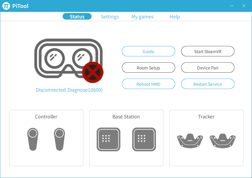

hey I’m backer #6135. I just received my 5K+ in the mail and I’m getting the 10600 error. I’ve tried a few things in other treads and this but nothing is working. Ive tried uninstalling pitool and deleting appdata files then reinstalling. trying other versions. flashing firmware. nothing seems to work.
I still use the disconnect reconnect method. Working so far. Just really annoying obviously. Pimax 10600 Fix

I had the Diagnose 10600 error as well immediately following a pitool and FW upgrade. Been trying for two days to get this stupid thing to start up, but all I’d ever get was the red light and no startup. Tried a million different things, including many of the suggestions on here.
I tried your suggestion finally and deleted all the folders in appdata after uninstalling all Pimax software including Pitool and Piservice. I did add one step and rebooted before installing Pitool again. After installing Pitool I followed the steps from Sweviver’s video (part 1) that is stickied on r/Pimax, which is basically
- plug in DP
- plug in USB
- plug in power
- start up Pitool
it didn’t work at first, but after turning off the headset and turning it back on while Pitool was running, it fired right up! THANK YOU so much for posting your fix.

INTRO:
Got my 5K + this week, once plugged all cables, installed PiTool, headset was found, then I tried to pair valve index controllers, only one worked, I started steamvr, got first impressions started to tweak IPD & on vertical IPD adjustments it crashed. Then it stopped to work. And I got exactly the same problem as current topic - red light, no HDMI/DP connection diagnose, I tried to do all tips & tricks for about 4 hours, googles all forums, tried to installed different PiTools, rebooted without HDM connected, connected it in order proposed above, deleted all user side folders (local, Appdata ones all of them), reinstalled pitool, it really started to piss me off. I really started to hate PiMax software by that time & believed in all that forums negative stuff. Ok then I found a solution & after that I was so happy with product I bought, but that bug ruined my first impressions though, just registered here to provide a way I solved the issue to others which will face the same dumn thing:
SOLUTION:
I started steamvr on its own even if PiTool said HDM is disconned, steamvr said that display is disabled & offered to rebooth the device (I tried to reboot HDM with power button (it issued sound & change in red light but it still kept red), I tried to reboot PI service many times itdidn’t work). However steamvr reboot device worked, but then it crashed again, but when it was working before the next crash (about 7-15 seconds) PiTools strated to recognize the headset. So final solution for me was to reboot the HMD with steamvr, plug out all headset wires from PC until it crashed in 10-15 seconds, then close steam vr, without rebooting anything plug in the HDM with all wires back & wow, all started to work good, then I srated steamvr from PiTool again & it stopped crashing.
SOME OTHER THOUGHTS:
I had impression that I got faulty unit or my wire was broken, but seems HDM has some state applied by software & the only way to get it back is to set this state back by other software, which was the steamvr for my case nothing else worked (service, pitoole reboot buttons, reboot, replug cables, reboot by HDM power button). Im so happy I figured it on my own, as headset gave me the impressions I even didn’t expect, the quality of screen is decent, I have valve index & it has a bit bighter colors, but LCD artifacts (integrity/ripple of the screen) is more poor than on Pimax 5k plus, although index not bad & a good one & large fov is great thing, pity that you can’t use your eyes & have to look straight, but the feeling when you look straigh is impressive.
Thanks for good piece of hardware. I know it’s hard to keep compatability with third party tools like steamvr as they also do betas, new updates & pitool can conflict with it, but it was not user friendly at all (wasted half of the day). I hope you will improve your software eventually.

Hi there, this error (10600) happened to me, i tried every tips i could find on forums and nothing worked until i ran the dfu program located on the pimax program files and reinstaled a new firmware that i found on the pimax/support Page.
Pretty easy!!
Hope it can help people still struggling with this…!
