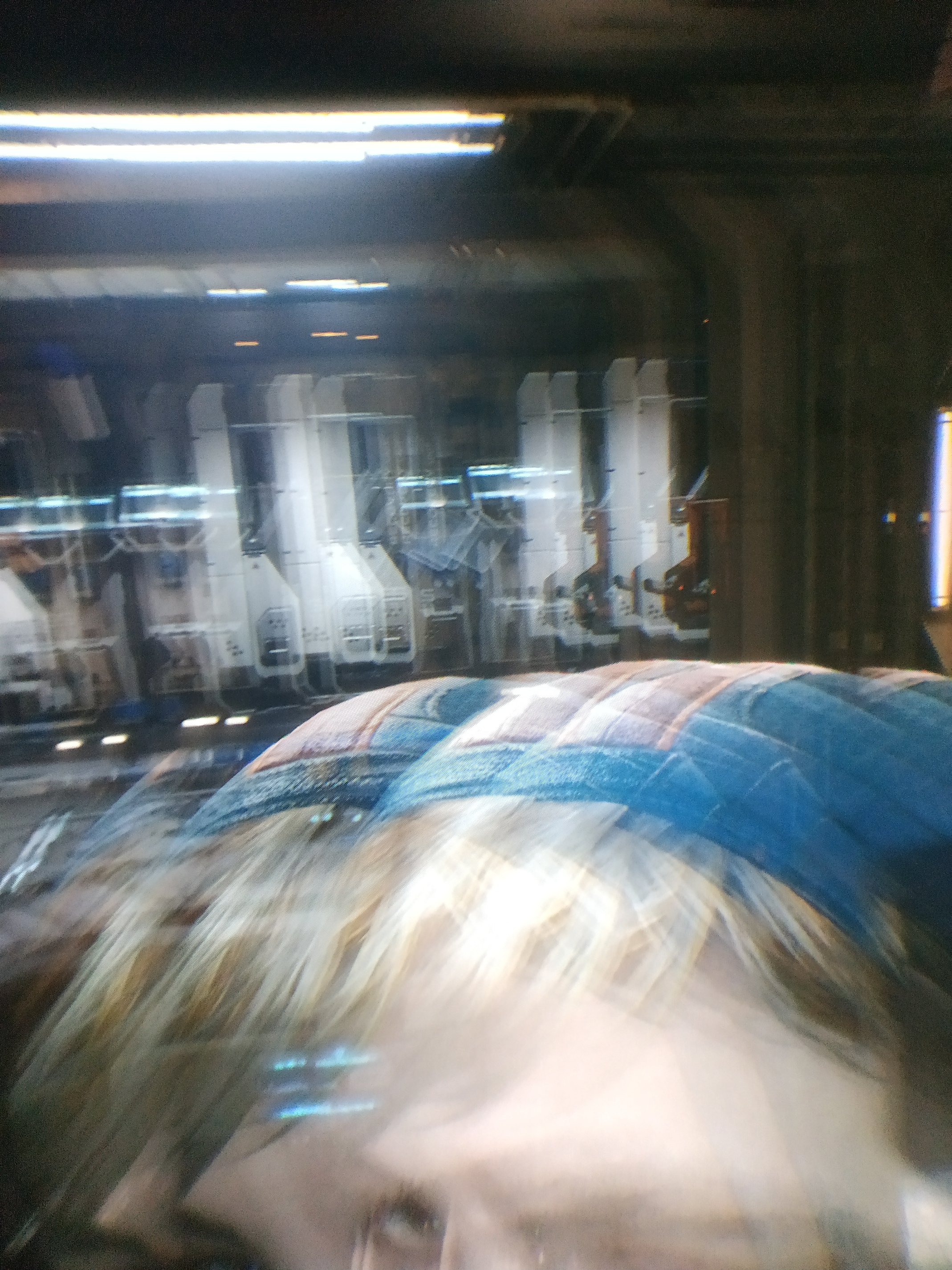

I have the same exact problem and watching my FPS drop to like 2-3, couldn’t figure out what’s causing it, even tried going back to 121 and some how the pitool 121 does the same now also…I ended up going back to 109 full release to get rid of the double image

Yes, same problem. Looks like a few of us are getting this. Never saw it before in previous PiTool versions. I am using same SS settings as before and also I am using i7-6700K and 2080ti, so it is not like I don’t have enough performance.

As I said it’s not related to PP and even with SS at 1 I get this problem in Lone echo and DCS.
@Sean.Huang
Any idea what’s causing this? Never happened with previous versions of PiTool.
It’s related to head movements, with some kind of overlapping ghosting of previous frames.

I saw something like this, when my framerate was really slow. When I fixed my supersampling factor, the problem went away. I’ve not seen this stuttering/ghosting behavior before. One other thing differed: I had Smart Smoothing enabled, when I saw the double images. That may or may not be related. (I did no investigation.)
Things don’t look good to me below 1.25 with the 8K, at 1 it’s too blurry.
With previous versions even if I was playing at a low frame rate I didn’t get that overlapped mess.
This version of PiTool introduces a lot of visual stuttering in some games (VRChat and Audica while the menu is visible were especially bad while testing) with and without Smart Smoothing enabled. Going back to PiTool 121 fixed the issue.
