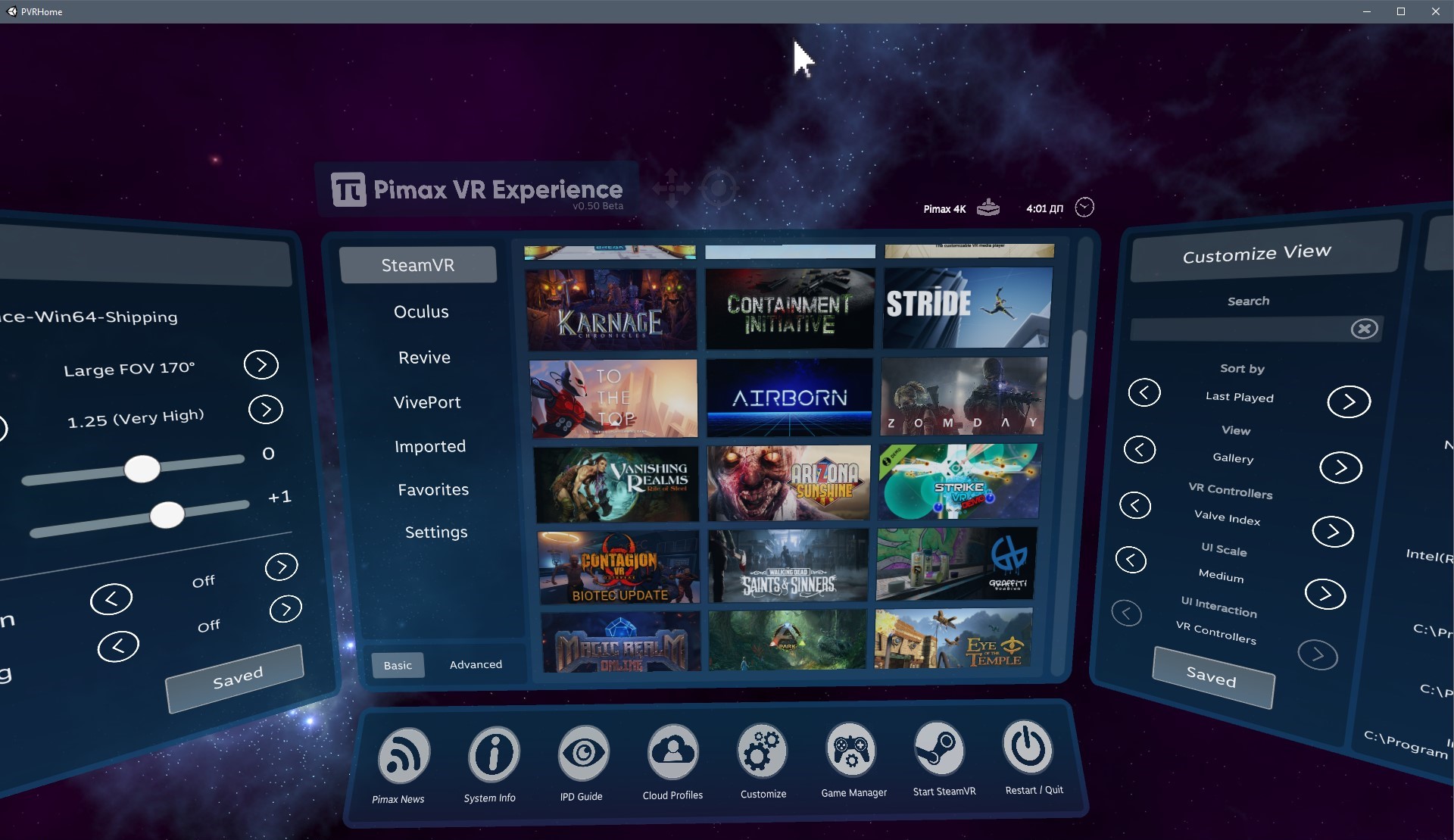

PVE works great with Pimax 4K in mouse mode.
I even manage to switch FOVs to very funny ones (the Pimax 4K has a maximum hFOV = 82 °, it can now be done 2-3 times less
BTW, mouse mode is great, but the mouse wheel does not scroll through lists.
Desktop screenshot:
Through the lense Pimax 4K:
