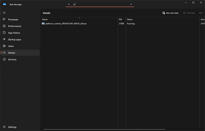

Which headset are you using? Please check if the IR LEDs around the lenses are lit.
Second, check whether the âEye Chipâ appears in Device Manager.
If youâre using the Crystal Super micro-OLED, also check if the related service is running.
I am using the micro-OLED module.
yes, IR LEDs are lit. checked with my smartphone camera. also eye chip is present and the service is running.

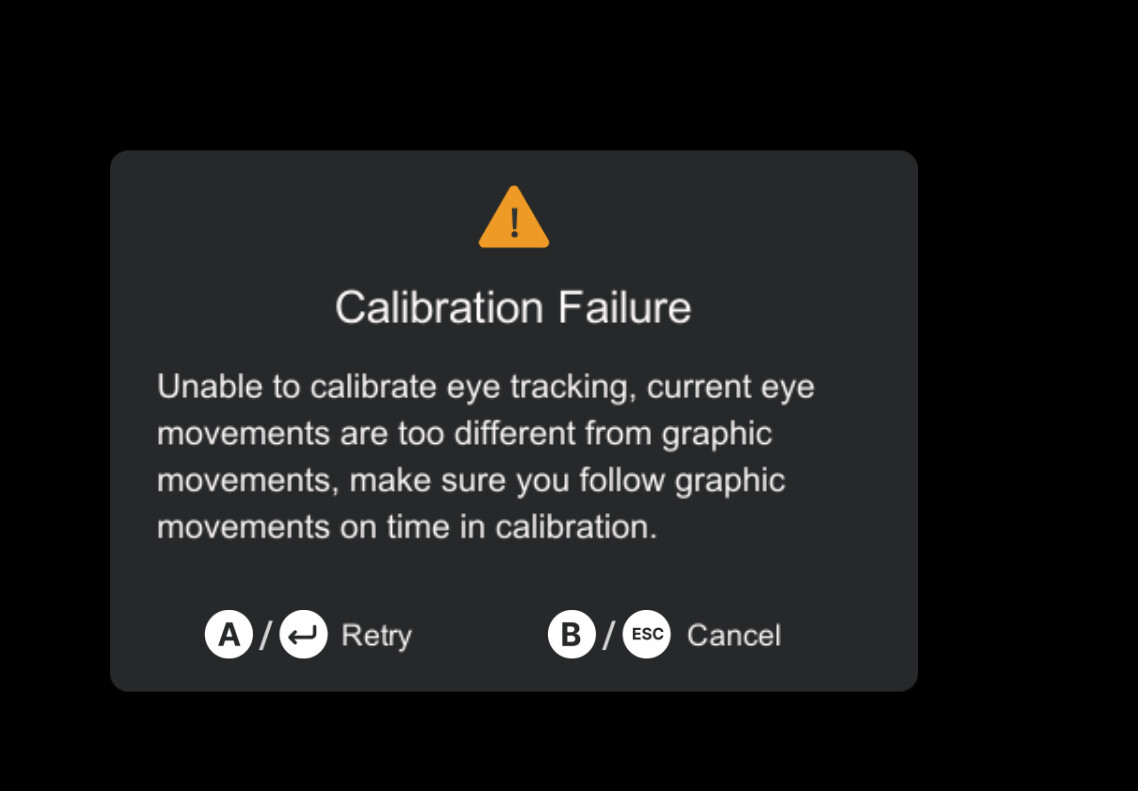

when I try to calibrate, I am getting this message:

Are you too close to the lenses, causing the cameras to be unable to detect your eyes?
no change when I am way back of the headset. ![]()
Hmm, you may want to reseat the cables and try again. If itâs still unsuccessful, please file a support ticket and include the log files so our developers can take a look.
ok, will do. thanks.
