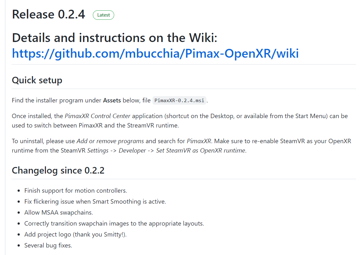

Pimax OpenXR Updated to v0.2.4
Much appreciated for the great work from @mbucchia !

Sorry for stupid question, but what it does, why I should use it? As I can see somehow it replaces steamvr. Will I get better performance in Dirt rally 2.0?

The Pimax engineers are providing support to me w.r.t my comment you’ve linked. They’re being super nice and they’ve helped confirm some of my findings and understanding so far. I’m looking forward to continue brainstorm with them.

Matt… it’s transformed MSFS- and it works great in DCS and IL2.

All I did is dl the Pimax XRControl 2.4 msi right click and install. Launch it from the desktop and select PimaxXR radio button. Launch either DCS or MSFS from Pitool (not Steam). If your DCS is not a Steam distro the you don’t need Steam running, otherwise run Steam but not SVR. Both games launch in OpenXR (SVR should not launch).
To stop running in SVR you can just close the Control Center. I haven’t used the toolkit app at this time.
Magnificent performance increase without SVR running in both sims…
