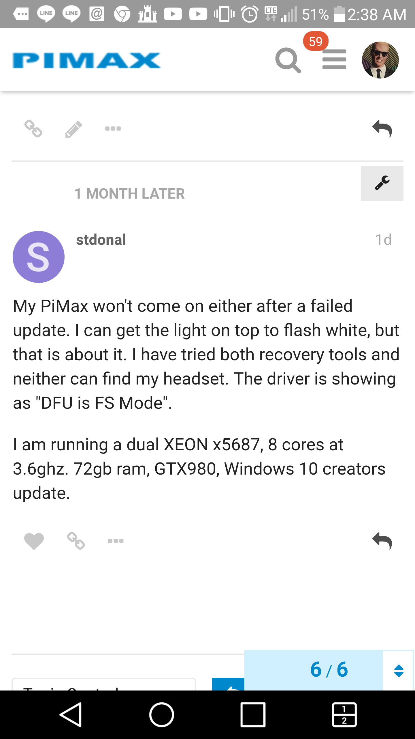

Your welcome. Here is his system specs. Sounds like has a server board judging by cpu & ram (definitely likely as is running 2 xeons)
