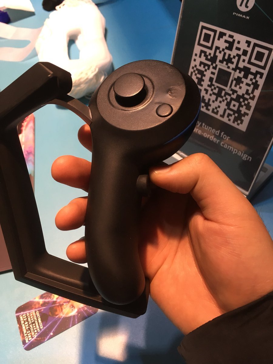

Pimax Knuckles Controllers
They have said they would strap down in the past.
Oops button fell off…
Doesn’t look like it fell off but was removed intentionally and i also have a guess why.
http://community.openmr.ai/t/controller-progress-let-us-know-your-thoughts/4652/92?u=skynet
I don’t think that the upper button could be reached easily and operated comfortably but that is speculation on my side based on my testing.
I like how people on twitter are freaking out about the controller because they think this means it will be made entirely of plastic, seemingly with no understanding of what it is they are holding.
