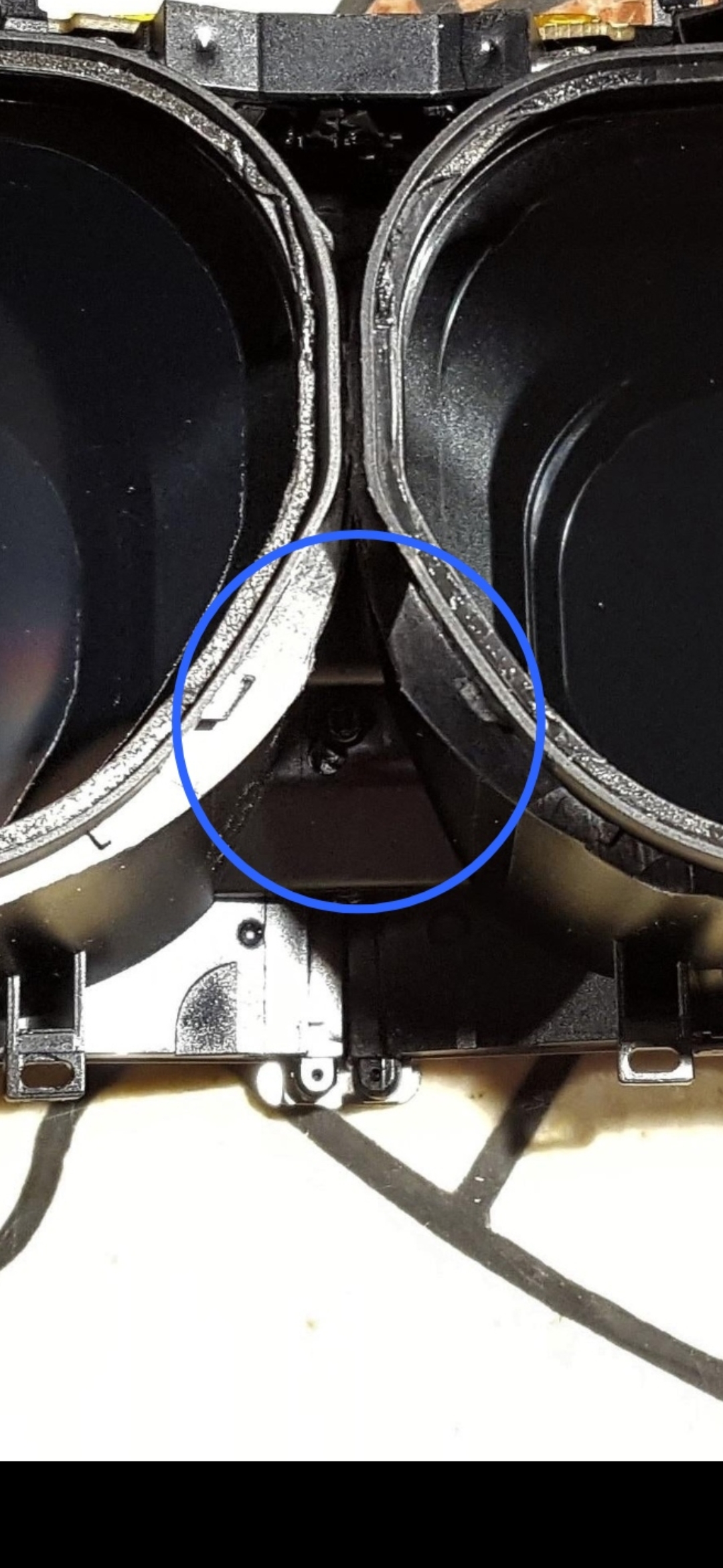

FIY: the closest it is physically possible to get the lenses center sweet spot is around (tolerance + 0.5mm) 62.5mm. Before the extreme mod is was around 66-67. I have em set to around 63.5-64 now and its perfect.
Sorry @jojon you’re screwed :wink: Maybe just maybe if we get index++ quality lens drop in its possible
So Pimax need to redesign the IPD slider, allow greater range, and the most important. A high quality drop in lens replacement.
This area could also be better designed. The headset is also unusable for people with a big nose or a high bridge of the nose. normal people also complained of the pressure on the nose. there is much to be improved. But it doesn’t matter what the community says, only what is heard.
