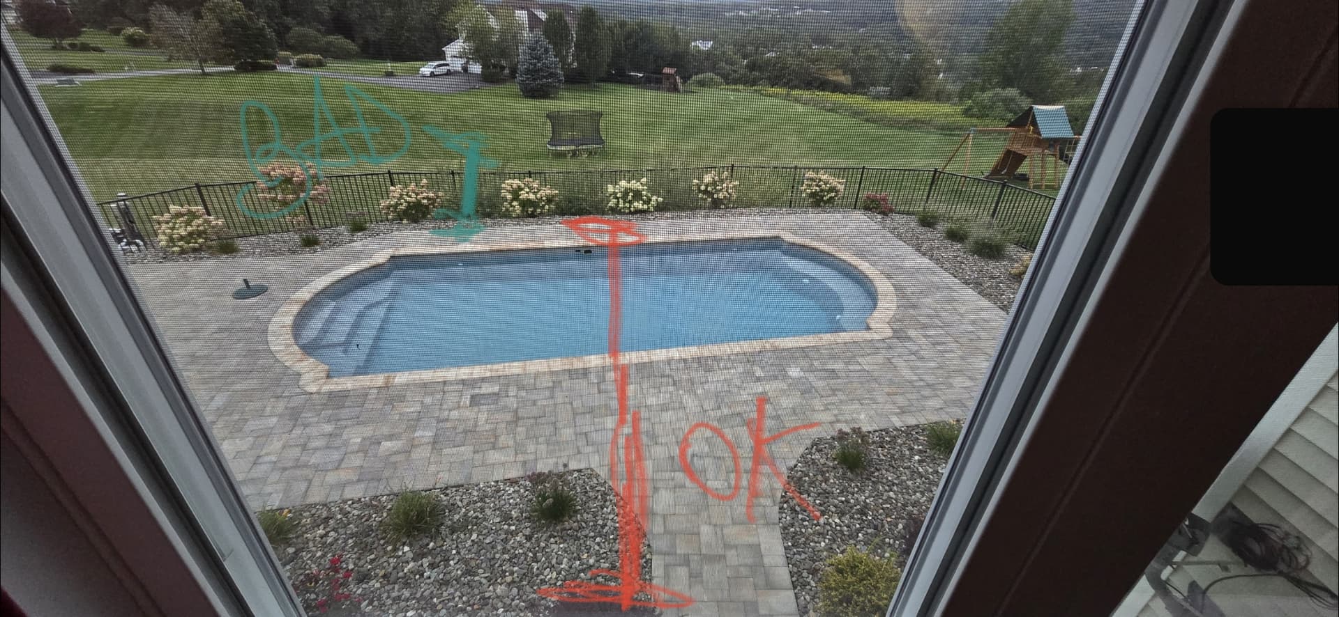

I just got a quest 3 and with steam link it seems i can play HL Alyx around the pool area while my pc is on the ground floor. The pool is at a lower lever .
Today i am going to see how far I can walk away from the pool with the quest 3, and around the land.

I have been testing with the quest 3 + steam link today.
I was able to achieve good quality wireless pcvr signal with HL Alyx running on my pc and quest , up to around the pool area.
When i step on the land though the quality of the video degrades. I have to change my wireless router and get something with longer distance capabilities. My internet signal degdades when going farther than the pool, even for just phone use via internet. Between the pool femce and the trampoline area, the signal is degraded.
Also quest 3 limits the play area boudary creation to a 25x25 area. Then that limit its use. Maybe there is ways to bypass this quest 3 max play area boudary setup and still add some sort of warnings when reaching out of a huge play area or gettimg too close to objects.

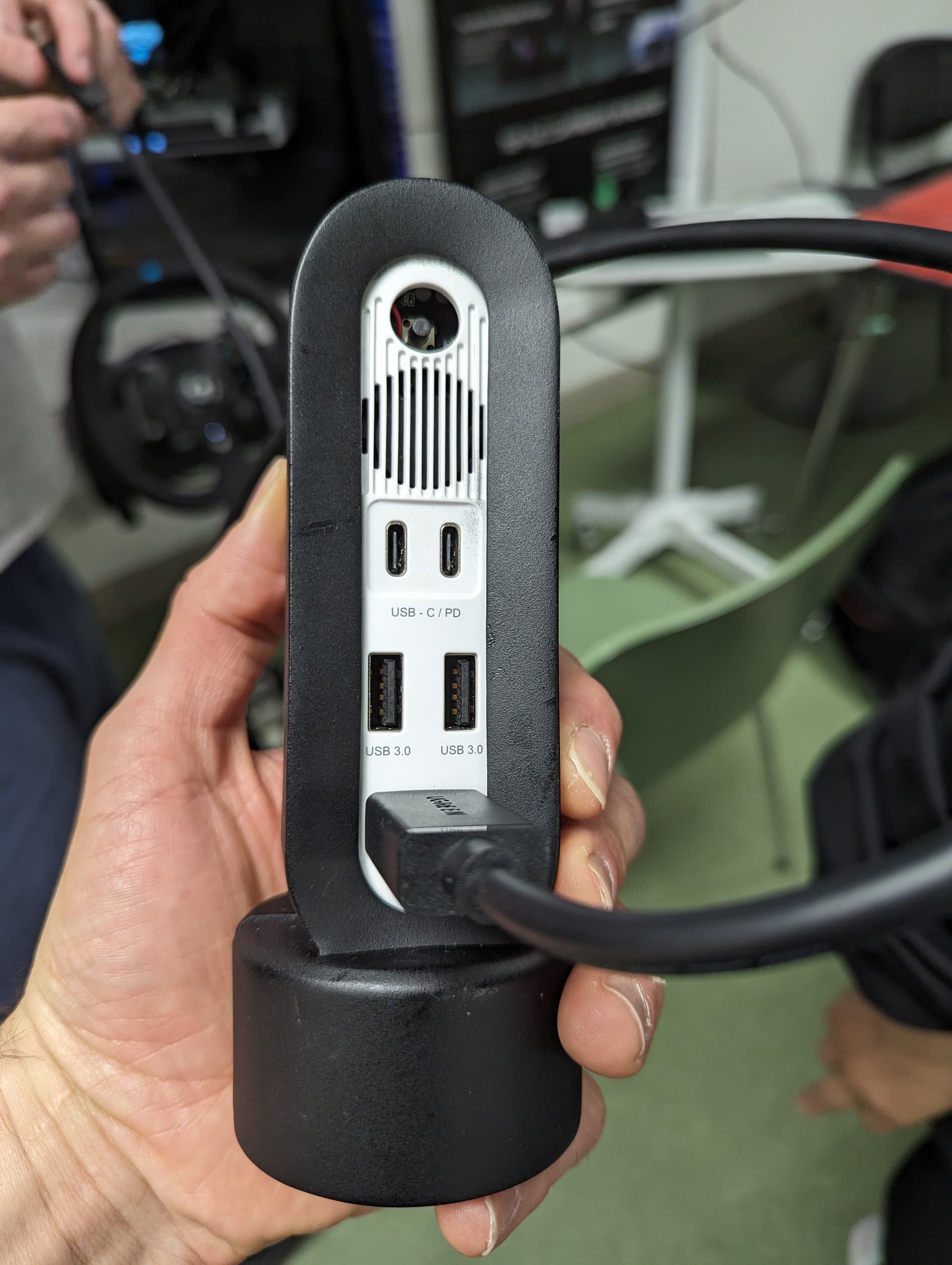

Here is something on a different note of interest using a rasp pi with a quest hmd.

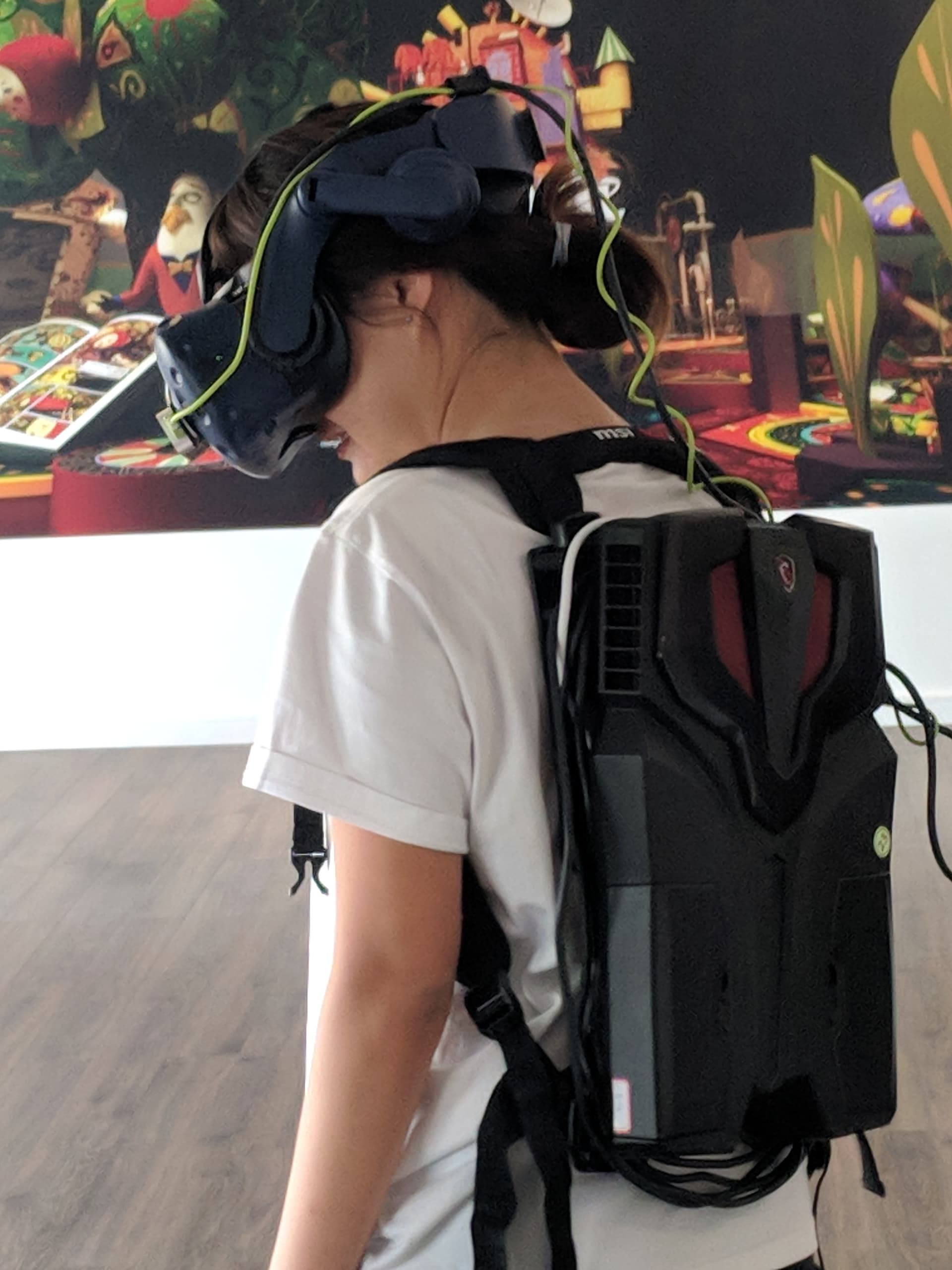

Loving me some backpack PCVR :moneybag::fire::hourglass_flowing_sand: :running_man:
Oh. I love it! Righrt That would be the solution to all the issues :smiley:
What pc are you carrying in the backpack and what is the power source for both the laptop + headset and how lomg the power last?

The whole PCVR backpack idea is pretty much over, afaik there are no current gen GPU options available anymore.
They were always just overpriced gaming laptops without a monitor inside a backpack with beefy battery.
The prevalence of performant AIO HMDs allowing for pretty high quality WiFi streaming made them obsolete outside niche venues and experiences.
