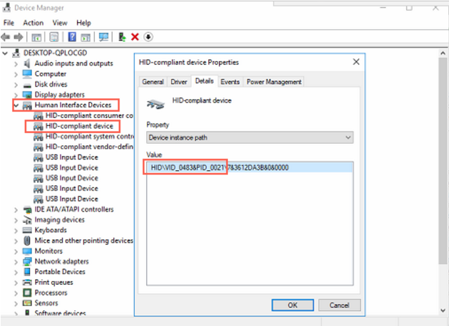

For connection issue, please refer to:
Connection Guide:
  1. HDMI cable directly inserted into HDMI port of computer independent graphics card (GPU)
  2. USB cable is inserted directly into the USB port of the computer
    after you insert USB cable, you will find a new HID compliant (e.g. 0483_0021=Pimax 4K)shown in device manager on PC. If can not find this HID device, please check your USB cable connection.
