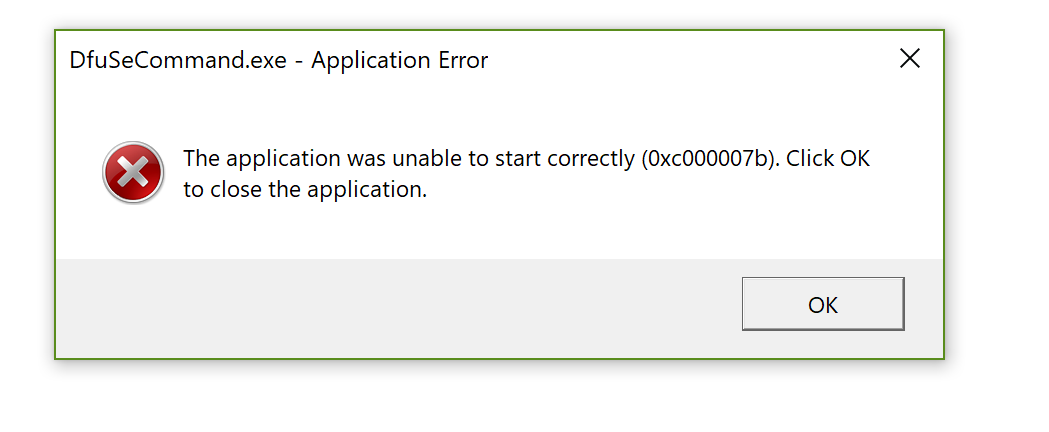

do u have any idea by any chance why the update tool from pimax is not working for me. so i can flash firmware or something .
A few people have had issues with pimaxs flasher tool. There is one that has been made by pimaxs community member @Sjef which works really well
community.openmr.ai/t/pimax-flashertool-by-sjefdeklerk/1968
thx.
this is getting crazy. i know they are small company and stuff. but this is just waste of time and money of lot of parties in whole.
this upgrade tool (both by user and official) just wouldnt work. it kept asking for missing dll files. with random luck i realised that those files are present in a runtime folder in piplay installation i copye upgarde tool files there and now i have this error
