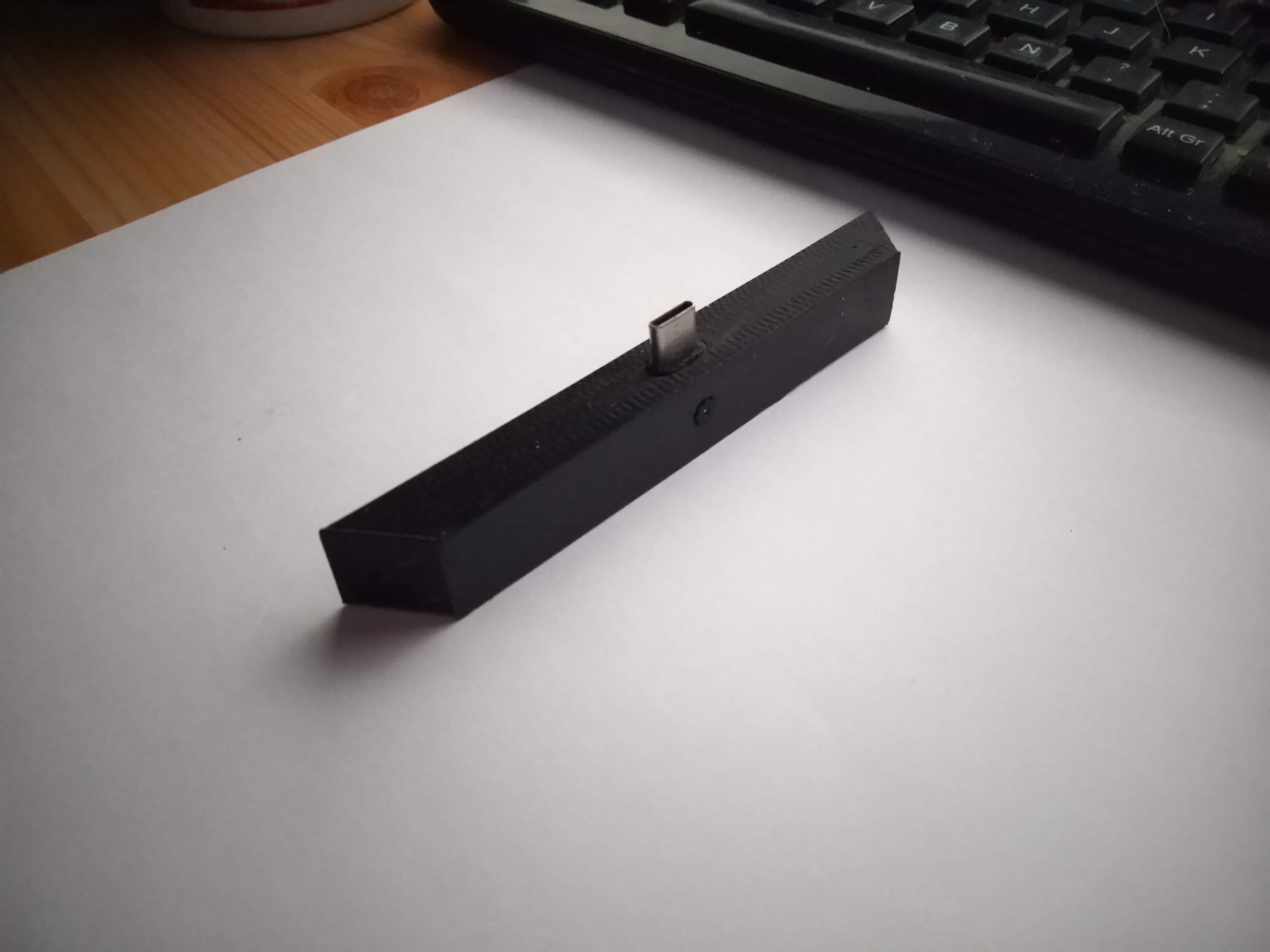

I designed this, its a pass through camera for Pimax headsets :
It is very light, weight 10 grams.

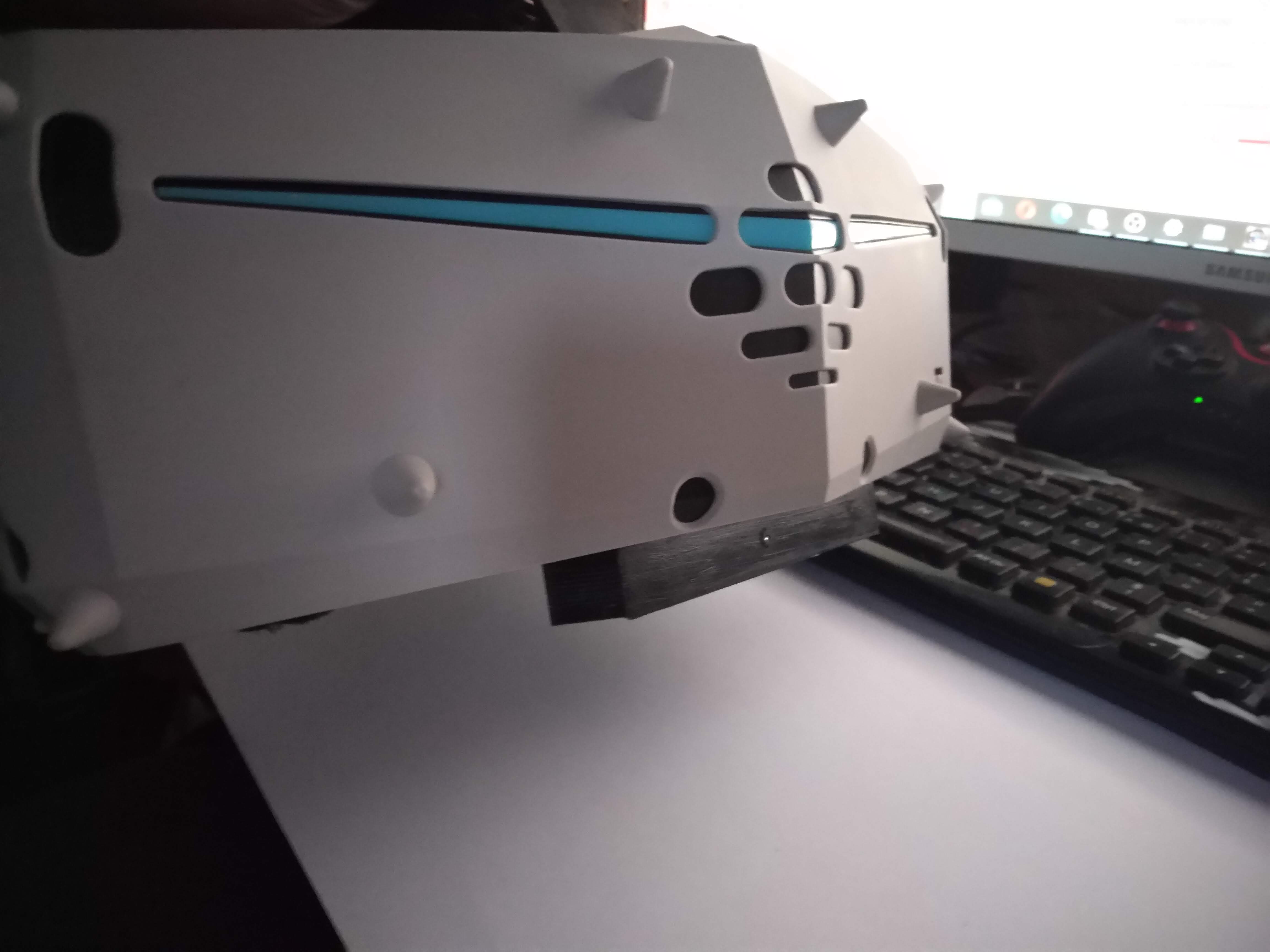

To be plugged on the lower usb C port, so light that it stand on the headset by itself once plugged in.
Here it is on my headset, can be used with or without the silicone protection.

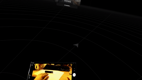

Unfortunately it requires a third party app like OVRdrop to be displayed in the headset using the Camera app from Windows 10 (to have a windows to display the camera so OVRdrop add it in the headset)
@SweViver or @arminelec could probably easily add a feature in PE to display it but it would not work for SteamVR.
Using Unity it should not be that hard to make a software to run in like OVRdrop, just for the camera app of Windows 10 but I dont know if it worth it, maybe if a very lot of you are interested …

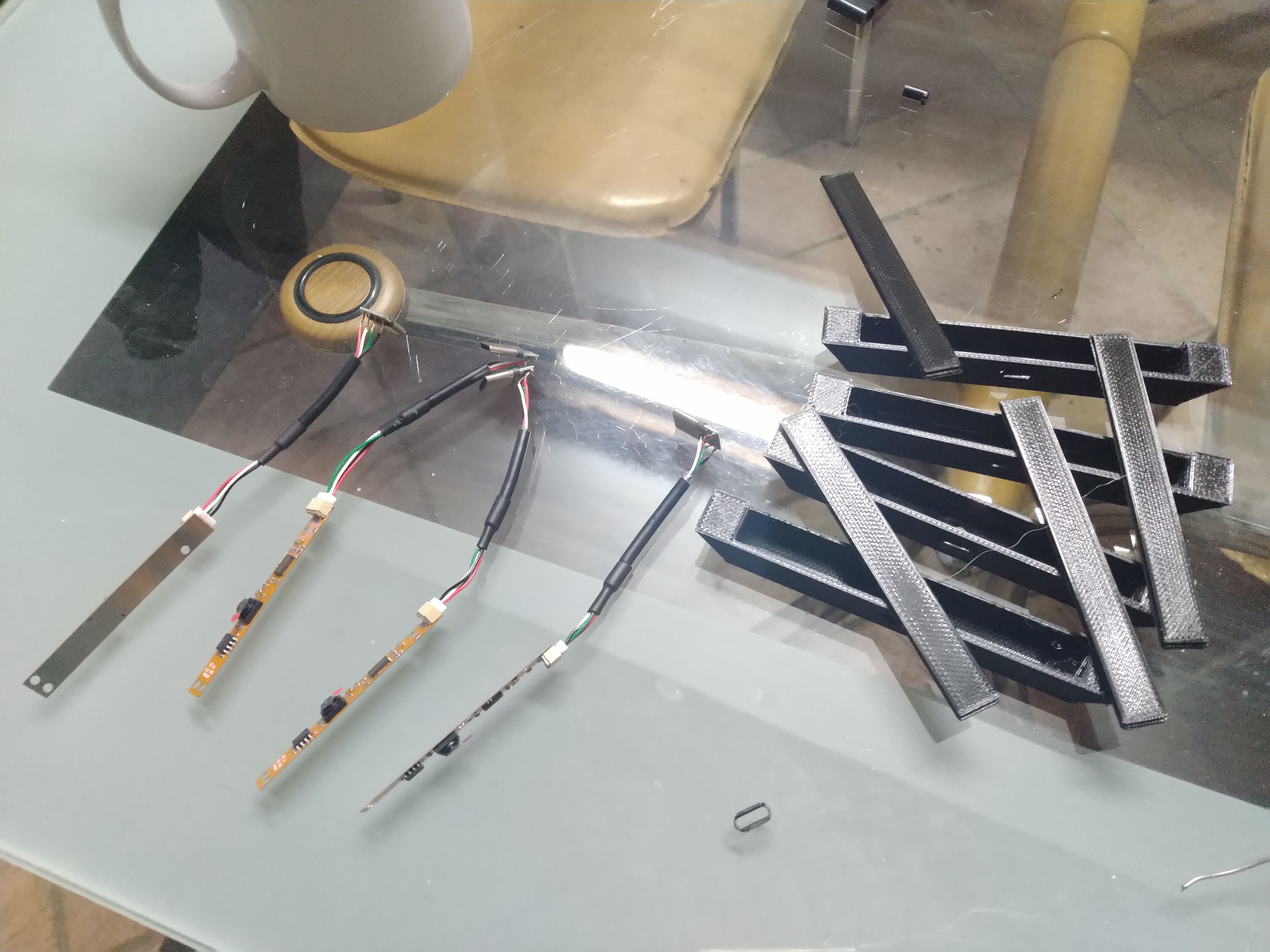

I will make a few more (4 or 5 but can make dozen if needed) that I will be selling once i’ve done every tests with it, mostly trying to find something else that the Camera app of windows 10 to have access to the camera settings but I am proud to show it already.
It is a 720p/30fps camera so it need light in the surrounding to see, of course an IR one would be better but much more expensive and maybe heavier.

I like it but I’d rather not have to choose hand tracking OR camera. I’m wondering if you can modify the housing to handle both? The hand tracking module does not seem to have a pass thru usb port, so it would have to go on the bottom, I would think.
@3D_FAN thanks ^^ yes using 2 cameras would probably be possible (using a micro hub inside the housing to use on a single usb port) but the hard part would be the software integration yes.
@Strydr Yes unfortunately cant use both on the low usb at the same time.
Using on one the top usb would require some new design but right now I dont see how we could attach it to the headset housing, but it is doable for sure.

I didn’t know the OVRdrop app, but have now found and tested the Daily OVR App.
Works fine, turn the controller and I see e.g. the camera or whatever.

Working on a few more ^^

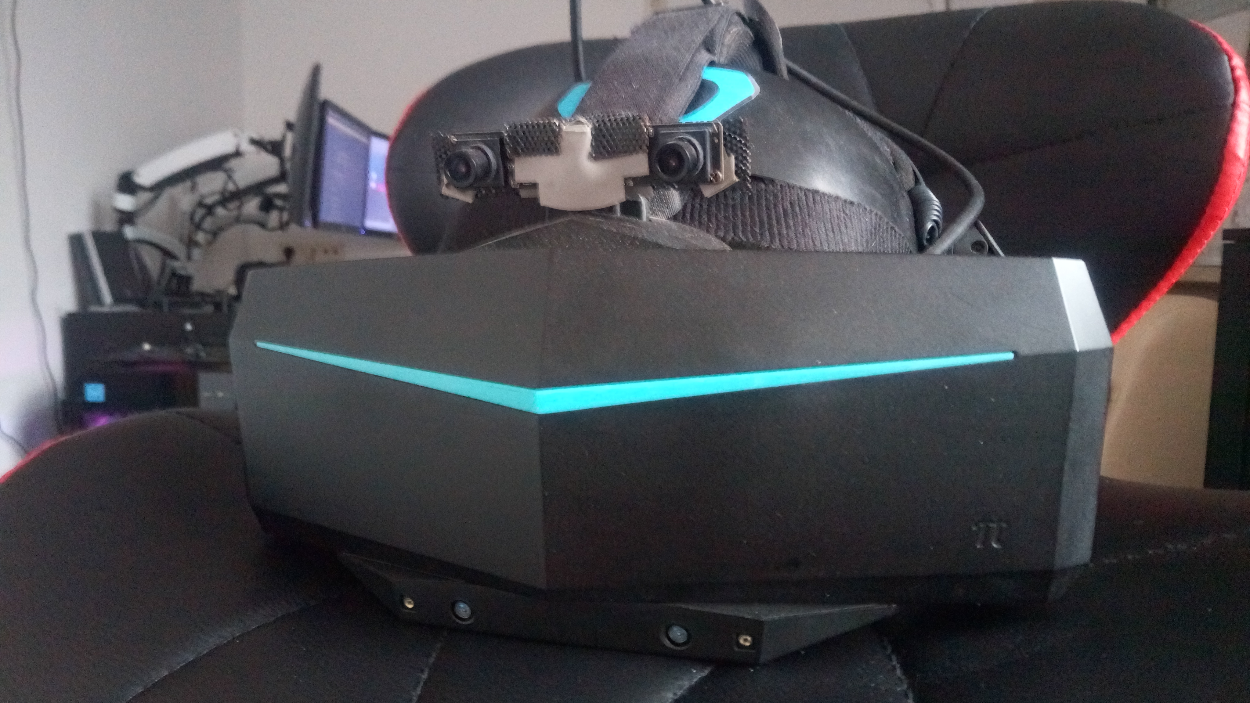

Yes, no problem, this is the model: ELP synchronization 3D USB 2.0 MJPEG 60 fps 1.3 MP UVC mini webcam dual lens stereo video USB camera
and I ordered it from amazon.
But there are even better options, because unfortunately this camera does not cover the entire field of view, 2 wide-angle cameras would be better,
but would also be a bit more expensive, the question is: What are you willing to invest?
You have to look, there are always advantages and disadvantages.
But you get a good, smooth picture with it and it is completely sufficient for the pure passthrough function.

Does anyone know if any of the HMD sensors would be occluded with the board? The silicon sleeve does have some cutouts in this area, but it looks like some could be cosmetic.

Actually I can make one that fit on the front side of the hmd with the camera set vertically, instead of a bar shaped it would be some kind of L or U, to plug on the lower usb port still.
I will see what I can do.
With ovrdrop you can flip/tilt the image so it can be used this way and since it is very small i don’t think it block the tracking.
