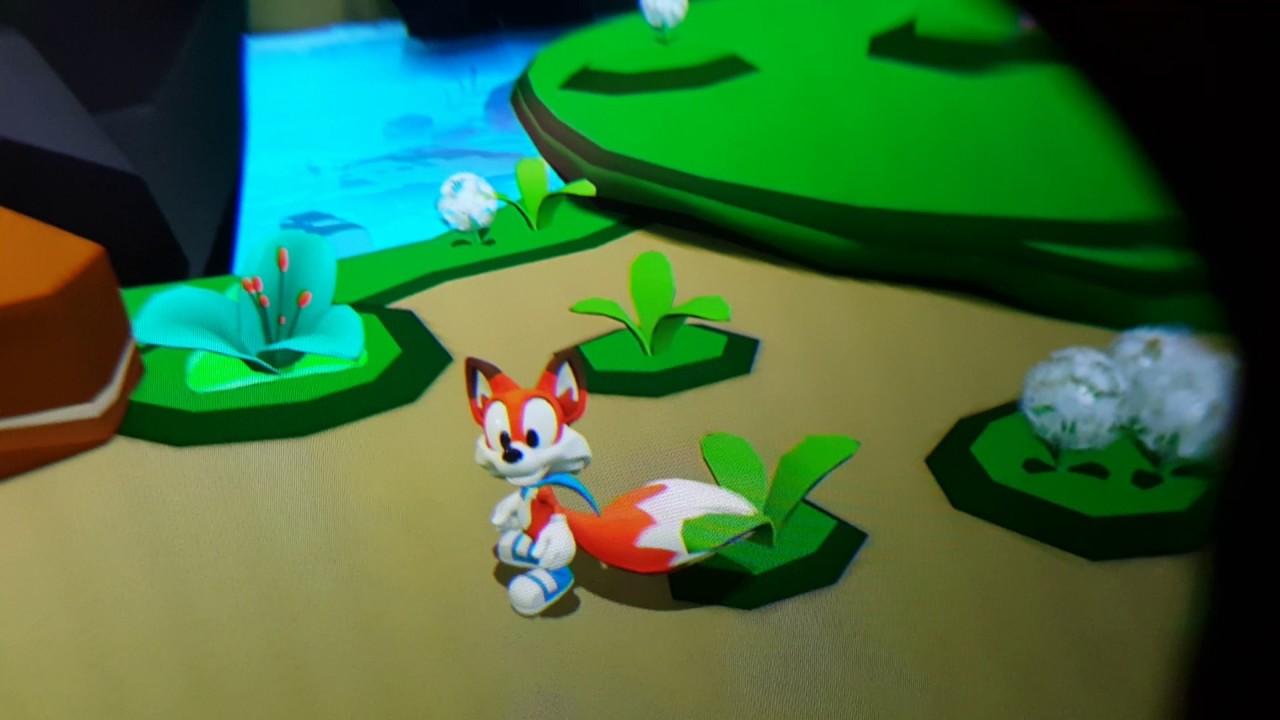

I rummaged through the SweViver archive and made a couple more comparisons.
**5K + left, 8K right**
So, when I looked at an enlarged view stretched over the entire 34 "monitor, then 8K seemed worse. And when the photo is smaller, then 8K is really less than SDE noticeably, smoother pictures. It’s magic. :grinning:
Now I understand why it is not necessary to increase image the comparison in order to understand the real quality.

I worked here a bit in the editor with these pictures:
sample
And I got equality in the number of pixels 5K + and 8K What can you say about this, Is this true or not?
