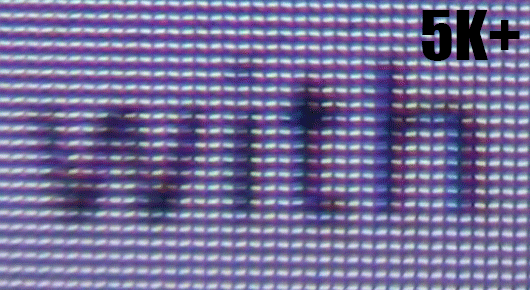

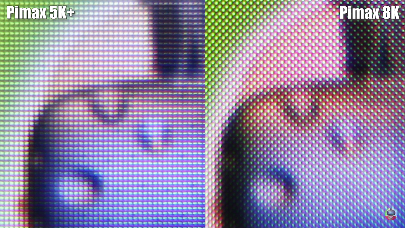

Big thanks for the video. Helps us understand the pixel pattern a lot more. It looks like both screens are indeed RGB, so I believe the biggest problem on the 8K comes from the upscaling.
On the 5K+ there is a high contrasting and well defined difference between the pixels comprising the text and the pixels that comprise the background. The 8K on the other hand has a thin subpixel outline that is half lit which is likely the result of upscaling. That thin outline is likely the average between the background and the text which is created when the original resolution is upscaled.
The best example of upscaling blur can be seen on the green circle gauge around the 9:10 mark in the video. The 8K receives the same signal as the 5K, but instead of making a clear line between brightly lit pixels and the black unlit pixels, it creates a slight face from green to black with some pixels in between being 50% brightness.

Pimax 8K still look like crap even if you maximize its rendering potential to the max. The lens matrix SDE pattern that they use are pretty horrible (it’s like there is a bunch of bees surrounding the text or objects you’re looking at)…they basically pretty much put a DEATH label to its potential by using this type of lenses. Something ain’t right about the pattern or dots…it needs more lights or something…why is it green or red when it should be white color. Probably due to upscaling BS resulting in pixels not getting the proper lights or dim…
That’s why I don’t understand when Sweviver said there is more definition or details far away…sure there a bit more dots but does it matter when those dots are blurry or not correctly light up? And you can’t even make out some of the numbers. So if you can’t see the numbers up close, how are you going to see something far away?? Therefore, 8K loses its definition and details. So what if 8K has less SDE or more dots to fill in…at that point…it don’t matter anymore since even maximize the rendering cannot help make it sharp. Now, I even want to question if watching movies is actually good with 8k here. How can it be better if it’s not clear up close? Or maybe it’s subtle when zoom out and that your eyes can just fill in the blank just as i predicted in another thread? I think 5K Plus is sufficient for me to play racing games and watching movies.
Yep also the first thing i noticed, shouldn’t this simply be a panel calibration issue?

Is it really hard to capture the 8K true definition than the 5K Plus? It looks like some of the 8K’s letters are clear while other have some part missing…aren’t they supposed to be in uniform throughout? In other words, if one letter is blurred all letters should be blurred…why only some part blurred. Is this the camera having a hard time capturing?

Unfortunately yes. It feels like the pixel pattern seems to be the bigger problem here than the scaling and rendering, thats why its still not as sharp even when rendering has improved with latest PiTool.

The reason why the images looks blurry its because it was shot with Macro so only a very small part of the image is in focus ![]()

While I have no doubt that the 8K has a 4K “pixel addressable” resolution (3840x2160), I think I see why Pimax has been so calcitrant about revealing the LCD panel details. From @SweViver’s video, I can see something interesting. Here’s the original video frame…
As you can see, both halves of the image are scaled appropriately, so the 2 sub-images are the same size. For what it’s worth, I actually prefer the slightly better distributed shades of color on the 8K.
Now take a look at the following close up, with the 5K+ pixels superimposed on the 8K…
Something is fishy (as others have mentioned). The 8K should have 50% more pixels. That is, for every 2 pixels on the 5K+, there should be 3 pixels on the 8K. If the 8K used a standard RGB stripe (like the 5K+) it should look like the small inset box, with 9 (3x3) pixels. It’s clear that the panel has a pixel arrangement somewhat like the maligned pentile pattern. It appears that the 8K pixels are either RB or G, not a full RGB stripe (as illustrated using the inset box).
