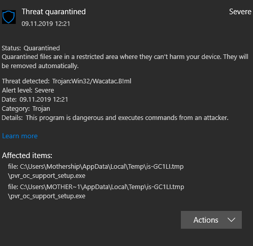

Hi all. can someone please explain this?
Popped up every time i tried to reinstall Pitool 197 to get the 120hz working on my HMD.
Did everything suggested. Windows update, new driver nvidia, deleting all pimax/pitool folders in appdata and so on. Still no joy PIMAX!
It’s supposedly a false positive, your antivirus software thinks the Pitool installer/files contains a trojan.
You can exclude the corresponding files in your antuvirus software.
do you think this may have effected the 120hz not working? ill try installing it, but i just figured out my HMD was manufactured the 49th week of 2018 (if the aforementioned info is true).
No, it should have nothing to do with the 120hz mode working or not. Well in a way it does, if you can’t install the latest beta version because of the antivirus software.
well, everything else works fine with new features and firmware update went smooth as well. Im posting the other thread which relates to this issue thou. Thanks for clearing up the potential tojan image
