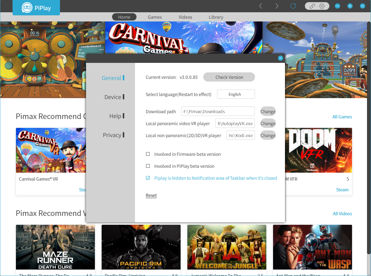

I have the same issue, after updating to the latest nvidia drivers and the version 3.0.0.85, PiPlay generated this OpenSSL Fatal error.
All the games are working fine in Steam. I just cannot start PiPlay.
So I uninstalled PiPlay and I have installed a previous version: 3.0.0.81
And this is working fine. It definetly seems to be a problem with the version 3.0.0.85
For information, I am using Pimax4K and a GTX 1080Ti
PiTool v1.0.1.76 is the best for P4k right now… give it a try!
Install as admin & It should install without the ssl error.
Where do you get PiTool and does it fix the bad ghosting in 3.0.0.85?

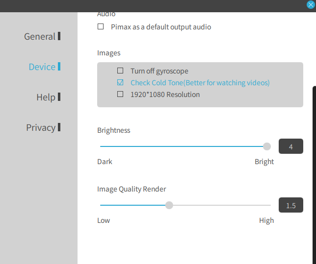

Maybe this is already widely known but you can unlock level 4 brightness by entering registry key located here:
c:\Program Files\Pimax\PiPlay2\QtTest\bright.reg
IMHO this should be enabled by default.
not finding the QTTest directory in that UNC Path? and searching in the Piplay2 directory, im not finding the bright.reg key either?
what version is this on please?
Eno
It’s 3.0.0.85 upgraded from 2.0.7 on Windows 7. Anyway here is the key so you can enter it manually:
Windows Registry Editor Version 5.00
[HKEY_CURRENT_USER\Software\PiPlay2]
“min_bright”=dword:00000000
“max_bright”=dword:00000004
Thanks I will add the key manually, might even try the dword value of 5 or 6 to see if it’s a good move!
Max value is 4, you can enter 5 or more into registry, but they have no effect.
